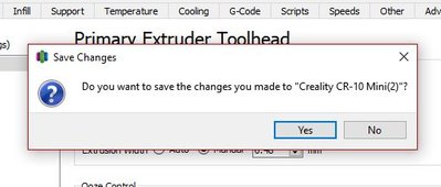

Save Changes when switching profiles
I'm confused on how I should answer this question.
I can be in a profile lets say named profile #1 and then decide to use another profile called profile #6. How should I answer this pop-up, I haven't made any changes to either one of the profiles plus it's asking me if I want to make changes to a profile I wasn't in? Actually why is it even asking me to make changes to a profile I wasn't even in?

Re: Save Changes when switching profiles
I hope you already found the solution to this problem.
If not or if anybody else is facing this issue here is my solution:
the message shows if you have two profiles which are named the same and / or profiles simplify can't find / write because of whatever reason.
Deleting / renaming these profiles did the job for me.
I hope this helps as I could not find any solution online, and it took me some time to get rid of this message.
