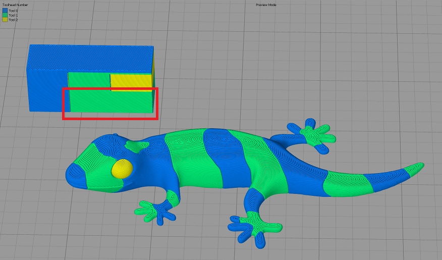

Here is what I see with the current Purge Block. The bit I have outlined in RED is still printed @ 100% Infil but really only needs to be 50% as the right hand half is only needed to support the Yellow section for when the print gets to the eye.
