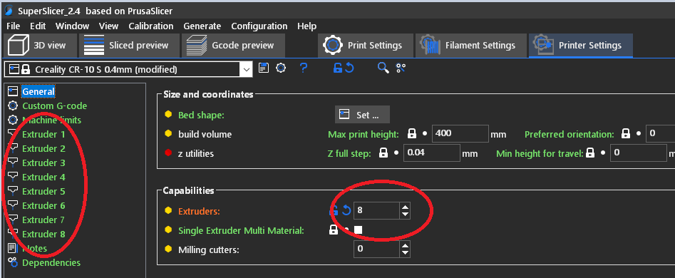

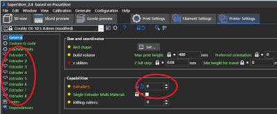

cbarry
Posts: 33
Joined: Thu Apr 18, 2019 1:52 pm
Re: multiple materials / multiple extruders / multiple objects
apparently it's not such a bizarre request after all... forces of nature may be pulling me away...
but I still need to experiment a lot more.
I would hate to go, but catch-up seems really hard at this stage.
we will see. meanwhile s3d needs to look around, see the exciting things happening in the world and get seriously crankin'.
Hopefully s3d has an answer, as there's a lot to like here, but it may not be s3d per se, but rather just me being in a rut and being loyal to them because I paid them money. I'm expecting that means 'better'. this may be an awakening... stay tuned.
