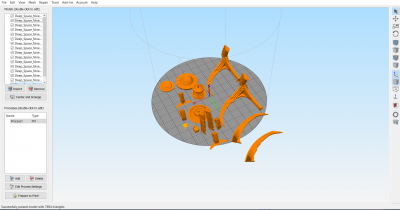

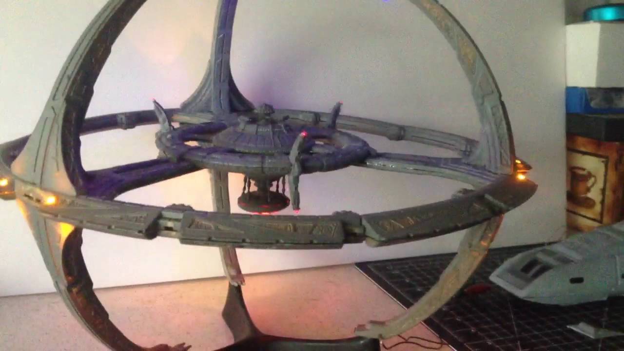

I know this may technically-speaking be asking for a lot, but I think it would make S3D really a cut above other slicers if it had the capability to more easily let you mate STL parts like assemblies. In the case of the DS9 model here for instance, my workflow would now be to bring the models into CAD and rebuild my print into a single STL file.

Making it a single model as in, rather than printing all the parts separately for a table or a chair, just print the table or the chair. In essence you’re arranging the base parts into the final target piece ahead of time in the slicer so they are printed as a single unit without joins or manual assembly processes.

That's not what I mean. That saves them as a "build plate" ie. a single STL of multiple parts; it doesn't do anything to position the parts in a meaningful ie. joined or assembled way. In the example in the OP I want the parts to arrange eg. into a top or bottom half of DS9 for instance:
Rather than as a scattering of components.
