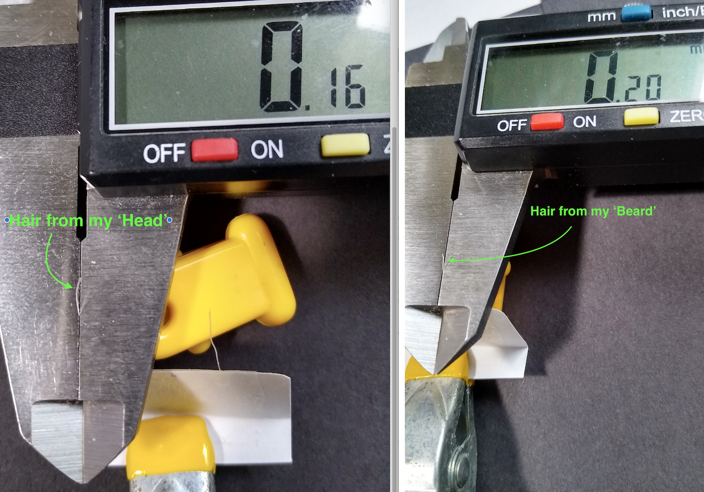

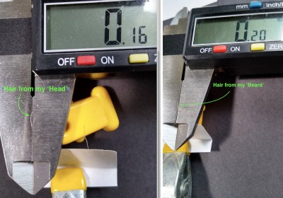

Neglecting what can be Googled about the size of Human Hair, I measured my own.
Head hair = 0.16mm = 0.006 inch
Beard hair = 0.2mm = 0.008 inch
Do people really think that plastic printing can be accurate enough to talk about dimensions of prints less than the ability of the printer to print when the machine is built to, at best, greater than 0.2mm Accuracy ???
Considering Belts, Gears, Backlash, Hysteresis (mechanical and electrical), Print Process, Speed....etc
And, do you really need the Printed Part to be dialed down to that kind of tolerance??? OMG!

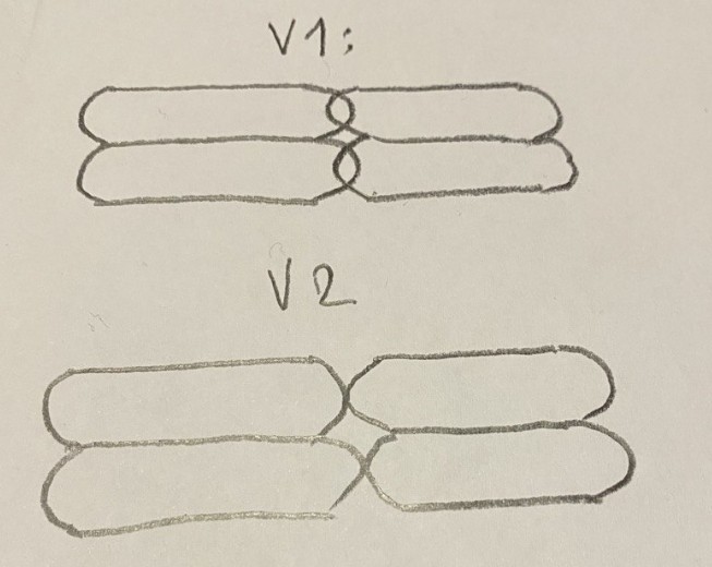

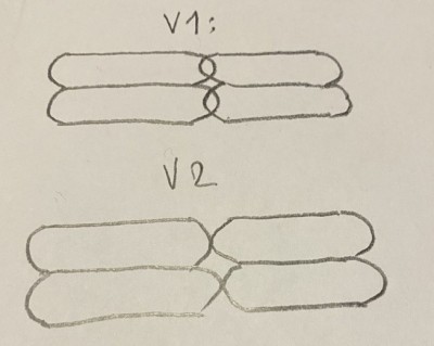

tomaski wrote: Sun Apr 19, 2020 7:32 pm What can be the reason that S3D is so much off?
They run under different assumptions and calculate stuff differently. One is not better than the other, they are just different.
Major difference is how they "expect" the overlap between lines to happen with 1.0 flow multiplier and extrusion width. (V1 is s3d)
