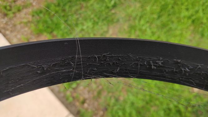

As you can see in the pictures I have a big problem of Stringing on the lower part of the room.
1/ I reworked my retraction parameters ==> increased the value to 8mm and the speed to 40mm/s it doesn't change anything

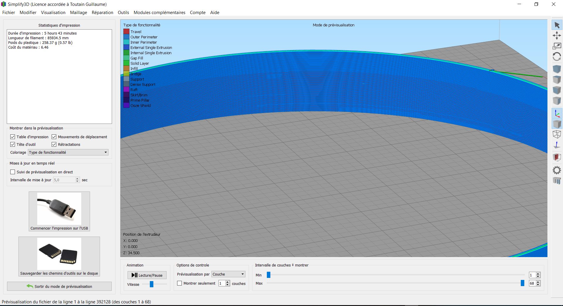

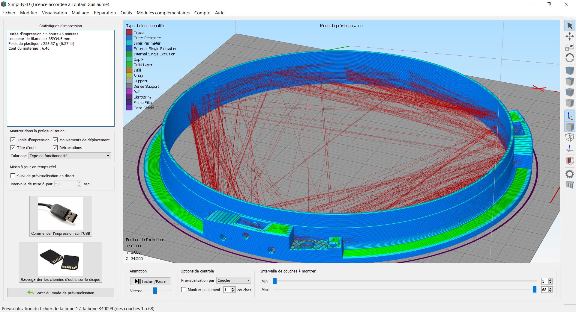

a) "advanced" - "movement behaviour" - activate ==> it gives the image without the movements BUT there are red lines for the movements which correspond to my bavages. They stop at the same place as the picture of the real room.
b) don't activate this parameter but then there are a lot of displacements too.
movement behaviour - activate = red lines = Stringing
