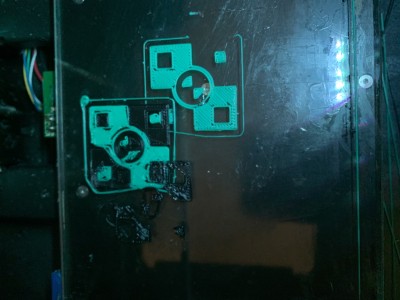

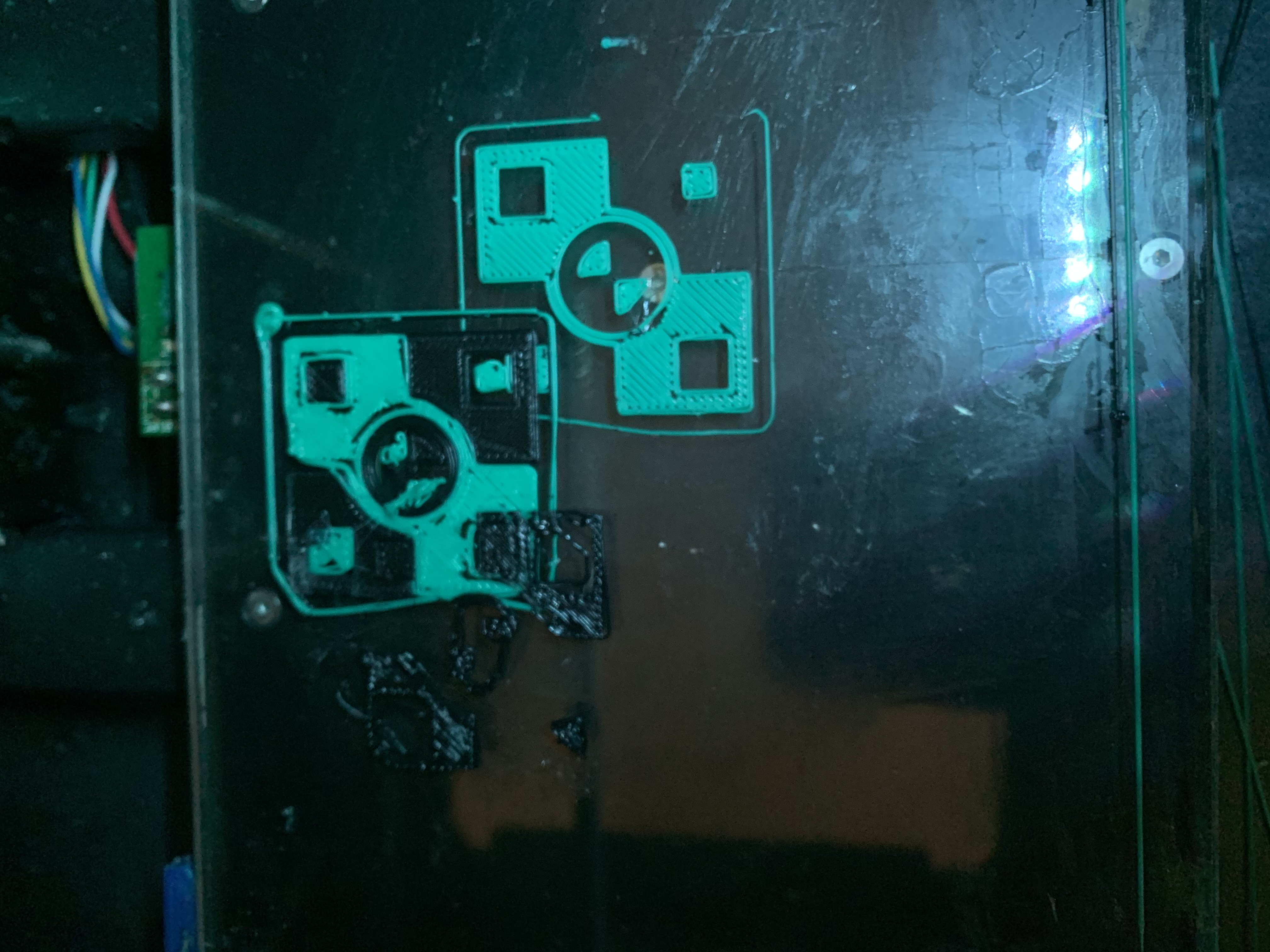

I've had S3d for a couple of years and fairly happy with how well it performs. Just recently I've gone through the efforts of repairing my second extruder and started trying to calibrate dual extrusion prints. I've been using this: https://www.thingiverse.com/thing:533814 to calibrate. My first print went much better than i expected. just a little tweaking with flow and retraction. however.. since that first print I've had issues where Tool 0 prints the first layer fine.. then it goes to tool 1 for first layer and shifts it left and up almost 30 mm (eyeballing.. not exactly) then it prints two layers.. then it switches to tool 0, prints another layer that is also shifted right from the previous shift about another10-15 MM..
Now in troubleshooting. I took the exact same processes. and printed one at a time.. and both printed exactly center where they were supposed to.. It is only when I attempt to print both processes does this happen.

sorry for the delay, was waiting on some new hotend nozzles and have been trying to re-setup the printer. After getting everything reset, I was able to succesully print a calibration print.. then I went to try the roadcone print.. and it did exactly the same thing as before.. no settings changed.
I've attached the factory file for what i'm trying to print now (road cone) as well as the other one that succesfully printed. , I did check the tool head offset box and it made it consistently off target, so I unchecked that

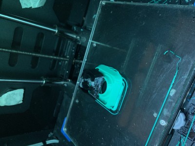

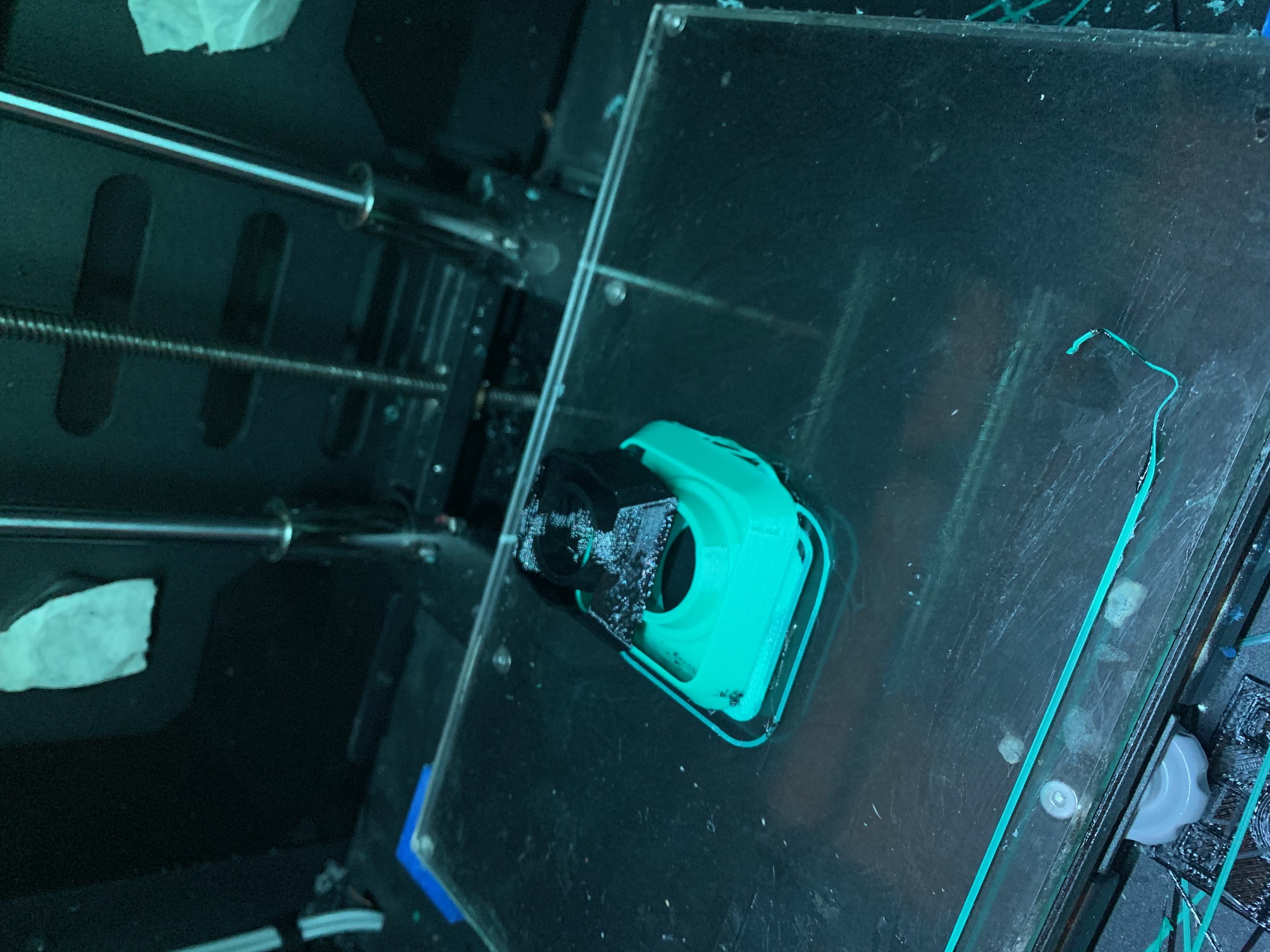

tried fresh... here's the factory file and the results of the print..

So it looks like the X offset is gone now. There is nothing in your previous files that shows there should be a Y offset. Can you post an updated Factory File just so I can verify this? If there is indeed no Y offset set there then this would seem to be a Firmware or hardware issue. Have you upgraded the Firmware on this printer?
