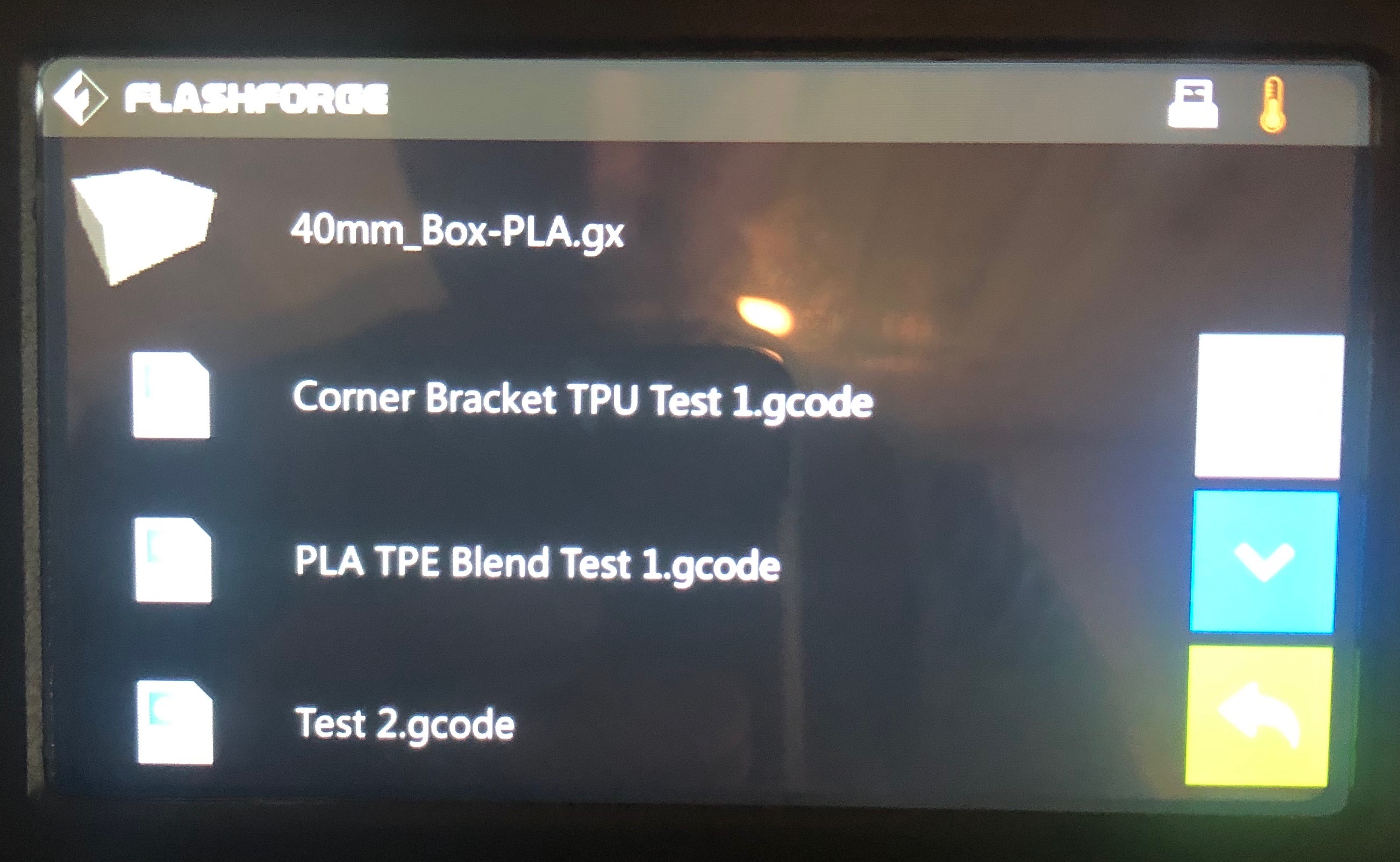

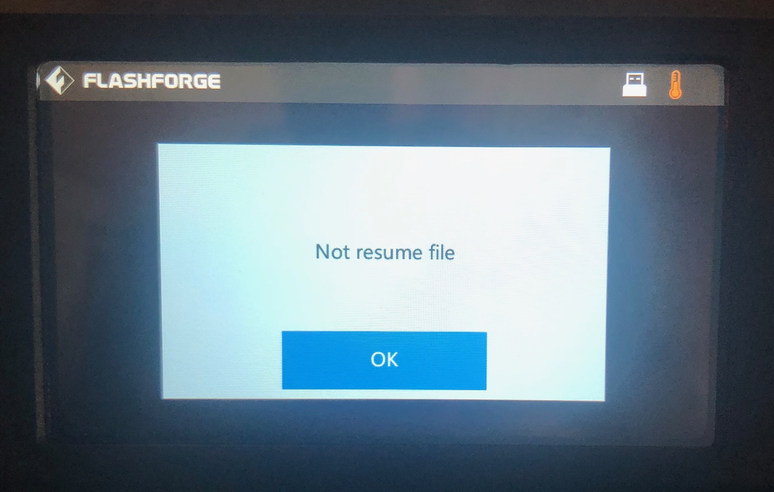

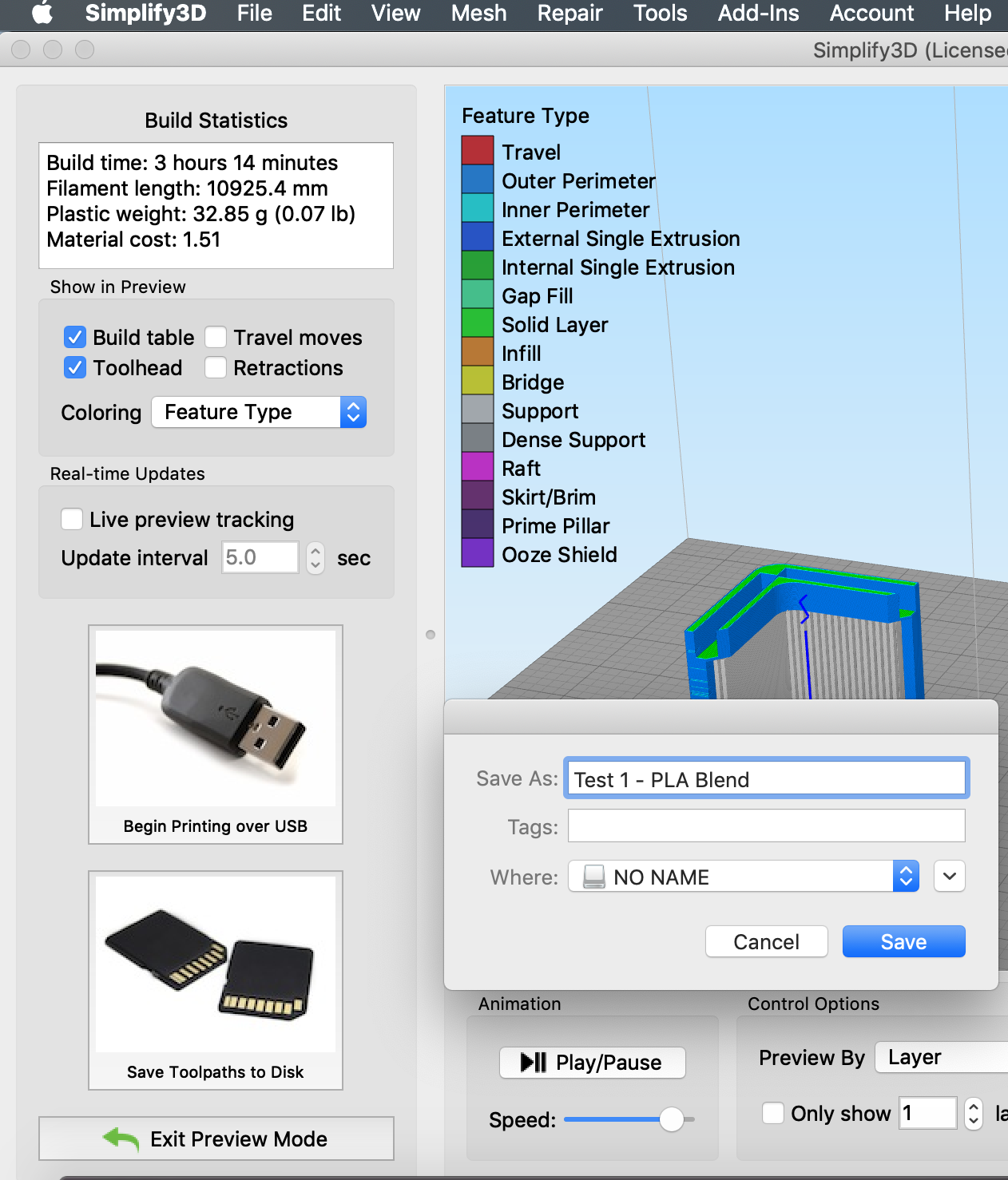

I'm very new to the 3D printing world and I'm having a tough time getting my print file from Simplify3D to the Guider II via a flashdrive. I upload the print file to the flashdrive, but once I've selected it on the Guider II, it gives me a message that says "not resume file" and the lights cut off. I've also noticed that the test file on the flashdrive was a .gx file while the file I'm uploading is a gcode file. I'm assuming this is related but struggle to type in anything to google/youtube that is useful to fix.

use this python script:
linum.py.zip
(333 Bytes) Downloaded 616 times
python3 linum.py [s3dgcodefilename].gcode
