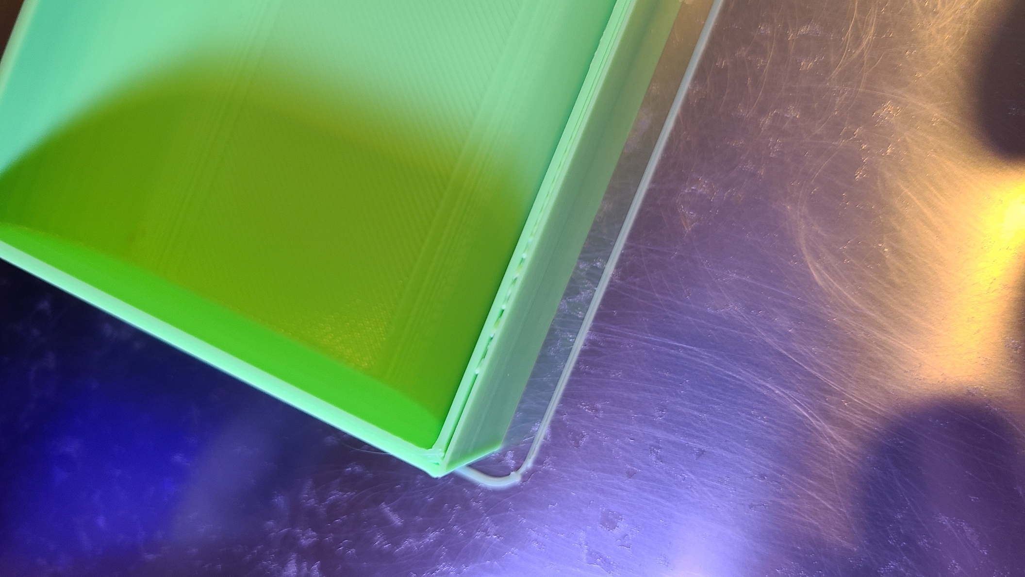

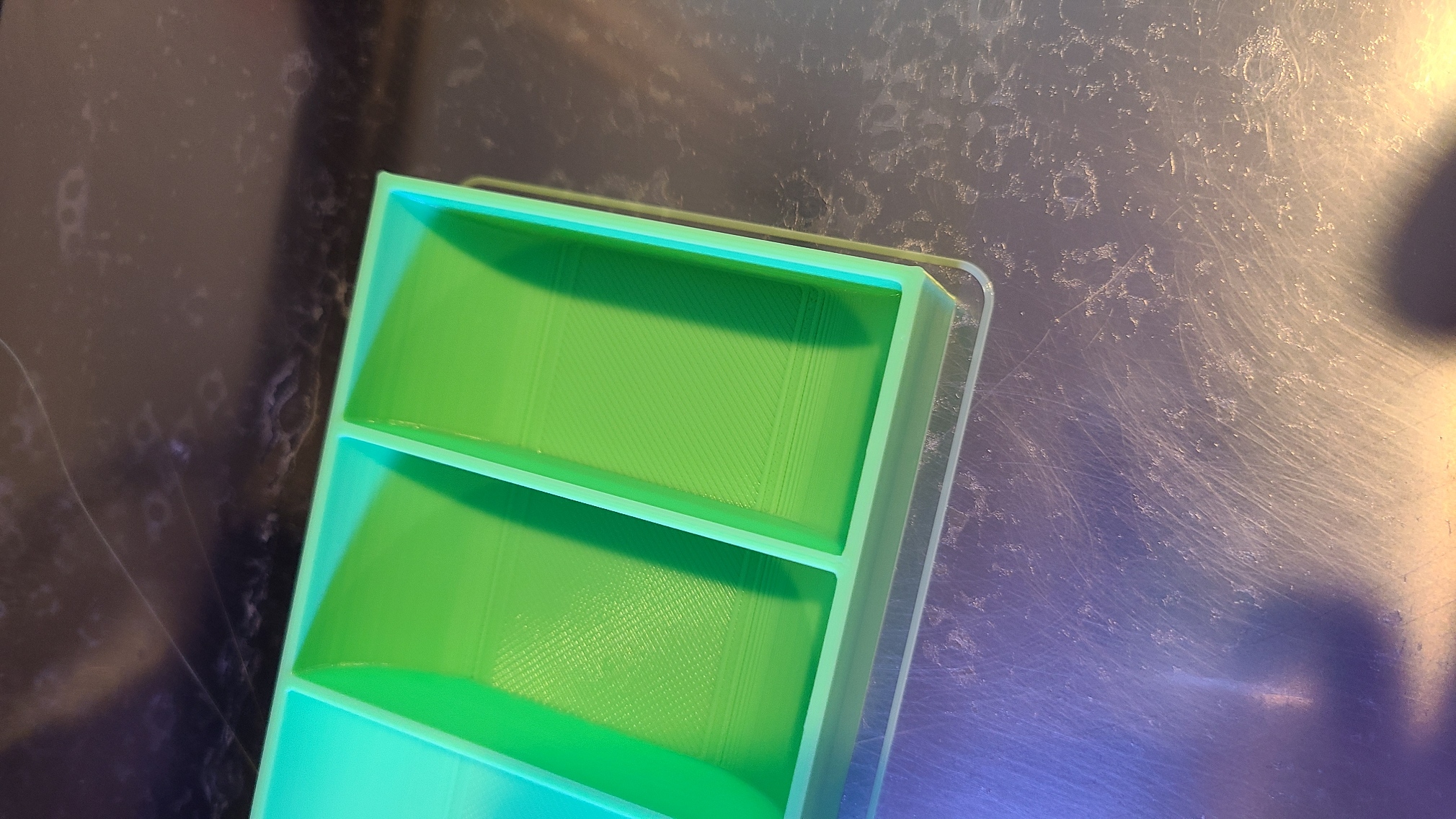

This may be similar to another post, but I have a model that when I print, just one corner ends with gaps between the inner and outer wall. The length of the gap seems to be much too big to be caused by coasting, and it only occurs on one corner.
Factory file attached for the model and all parameters.
CR10sPROMSv3-Example.factory
(26.36 KiB) Downloaded 140 times
airscapes
Posts: 403
Re: Wall gaps just at Start/Stop of final layers
On the extrude tab uncheck coast at end, and wipe nozzle, On the advance tab, turn off everything in ooze control except for only retract when crossing open spaces. If your machine is a direct drive reduce your retraction to 1.0 and retraction speed to 40mms . Reduce your print speed to 50mmS
Try the print and see how it looks. I do not own your machine but give it a go and see what happens.
