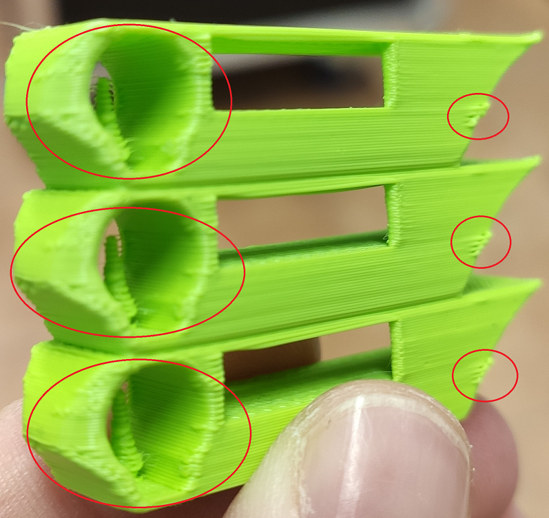

My prints have paths outside the model. The problem is visible in the photos I atached. How I can fix this issue?

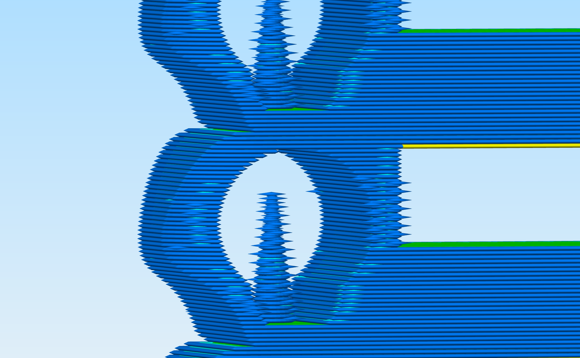

These are preview visualizations of retractions. On the left you can toggle retractions on or off for the preview window.
You are right. So if retractions are visible on the prints as seen in the photo I must change retraction options?

Yes! Your profile's extruder tab's retraction settings need altered.
