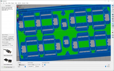

I'm also using this feature quite often, so far I didn't encounter any bad surprises I can remember of. Anybody happen to
have a factory file showing an example?
Tested this with 4.0.0 and 4.1.2, all niceley aligned to 0, 0 (lower left), seems to work as expected!?
