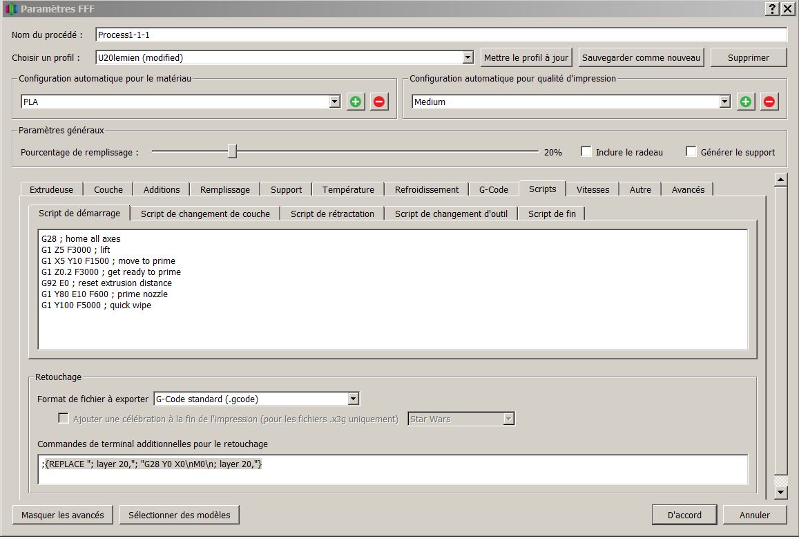

Hello,
I occasionally insert objects into my prints.
So I integrate the command {REPLACE "; layer 20,"; "G28 Y0 X0\nM0\n; layer 20,"} at the bottom of the "scripts" tab, in the field"
The problem is that with the G28 Y0 X0 coordinates, the plate goes back to the bottom I often have problems inserting my objects.
So I tried to do G92 Y200 X0 but that doesn't work either.
What would be the correct command for my tray to go to the front of the printer?
Thank you

If 0,0 is the corner of the bed closest to you, you'd want to send the nozzle to the Y max. So if your build area is 200 x 300, you'd send a "G1 Y300 ; move to Y max".
