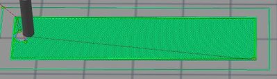

Hello
If a layer is finished and he wants to the next point then a transport line in the layer.
How can I make sure when he starts with the next layer that he (bv.0.3mm) is above the layer before it is moved to the starting point.
M.v.g.
KeyboardWarrior
Re: several Stripes in design
Under the Advanced tab, use the Force Retract at end of layer. Then under the extruder tab, enable a Retraction Vertical Lift of .3 mm.

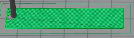

hello
It has become better at every layer of the producht he goes off.
But as you see in the picture as he continues on the same layer losing an line how can I get this way?

OnlineSjoppen wrote:hello
M.v.g.
Hello
This problem is solved by the next line.
only retract When crossing open space,
to clear the checkmark
