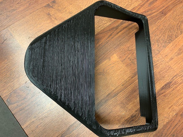

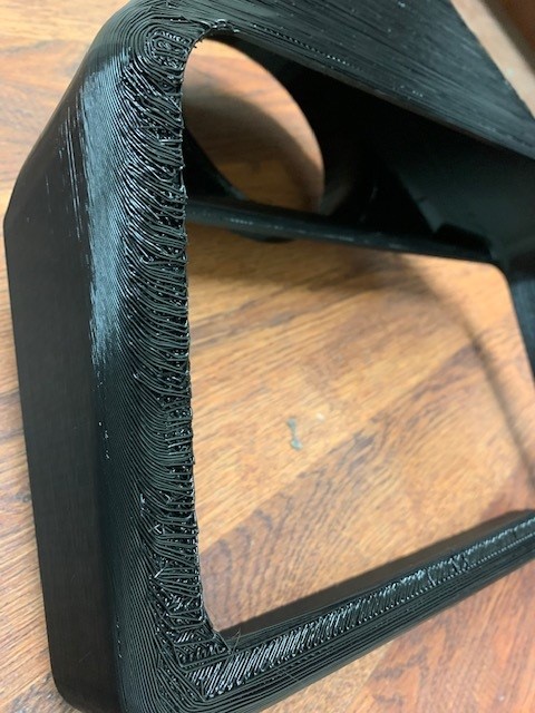

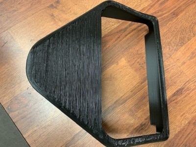

Hi everyone, i have recently been working with a Builder Extreme 2000 printer. It is mainly used for large scale prints and has dimensions of 700 x 700 x 1700 mm. Currently i am trying to print an air intake for a bike which will be provided below. As you can notice from the pictures, the top and bottom layers don't quite seem to fuse together properly and make a solid part. I have been tweaking the settings and finally got a rather decent print but there is still stringing in some areas and the part won't make fully solid layers in certain areas leaving gaps. The nozzle being used is a 0.8mm nozzle and the filament is PLA. In this specific model, there is little infill because the walls are so small. Here are some of the settings i have that might be useful to know(Note: these current settings have provided the best print quality so far). Any assistance would be greatly appreciated!

Re: Top and Bottom Layer Gaps
You're printing rounded surfaces above supports. This is one of the more difficult types of geometry to support fully without resorting to a water soluble support material solution. The link below has some tips on how to increase your chances of success with these features.
Brochel27 wrote: ↑Tue Mar 15, 2022 4:19 pm -upper vertical separation layers: 3
-lower vertical separation layers: 3
I would set this to 1 for upper and lower unless you're having an extremely hard time removing supports from the finished print.
zemlin
Posts: 434
Set your separation layers for 1 top and bottom. If support is hard to remove, increase your layer thickness. If build on top of support is messy, reduce your layer thickness.
