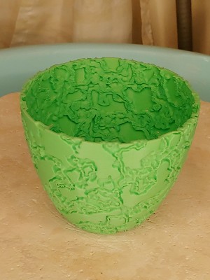

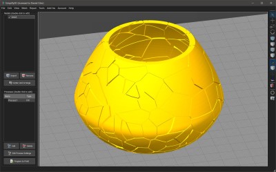

I am printing clay form for internal fill and would like to preserve inside relief, but the inside outlines make it more fat and distorted (see image).
I know about "vase mode" but it will not helpfull, because it is too thin - I need at least 3 shells.
Can anyone suggest any trick to swap inside/outside ?

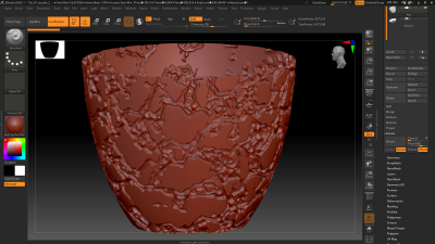

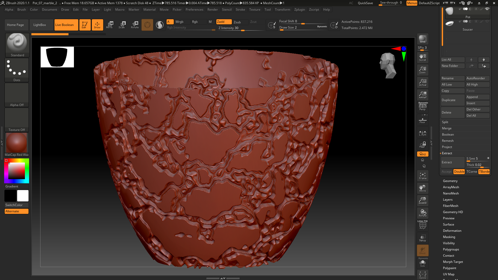

Model has zero-thickness wall:
Thanks in advance.

I think you are either going to have to redo your model so it has thickness that matches what you actually want to print or do something to trick the slicer into doing what you want. The only thing I can think of would be to make as many copies of the model that matches the number of perimeters that you want, and scale each one in x/y just enough to make it one perimeter bigger, and then print each stl concurrently with one perimeter. Not sure that would work though, I definitely would attempt to remodel first.

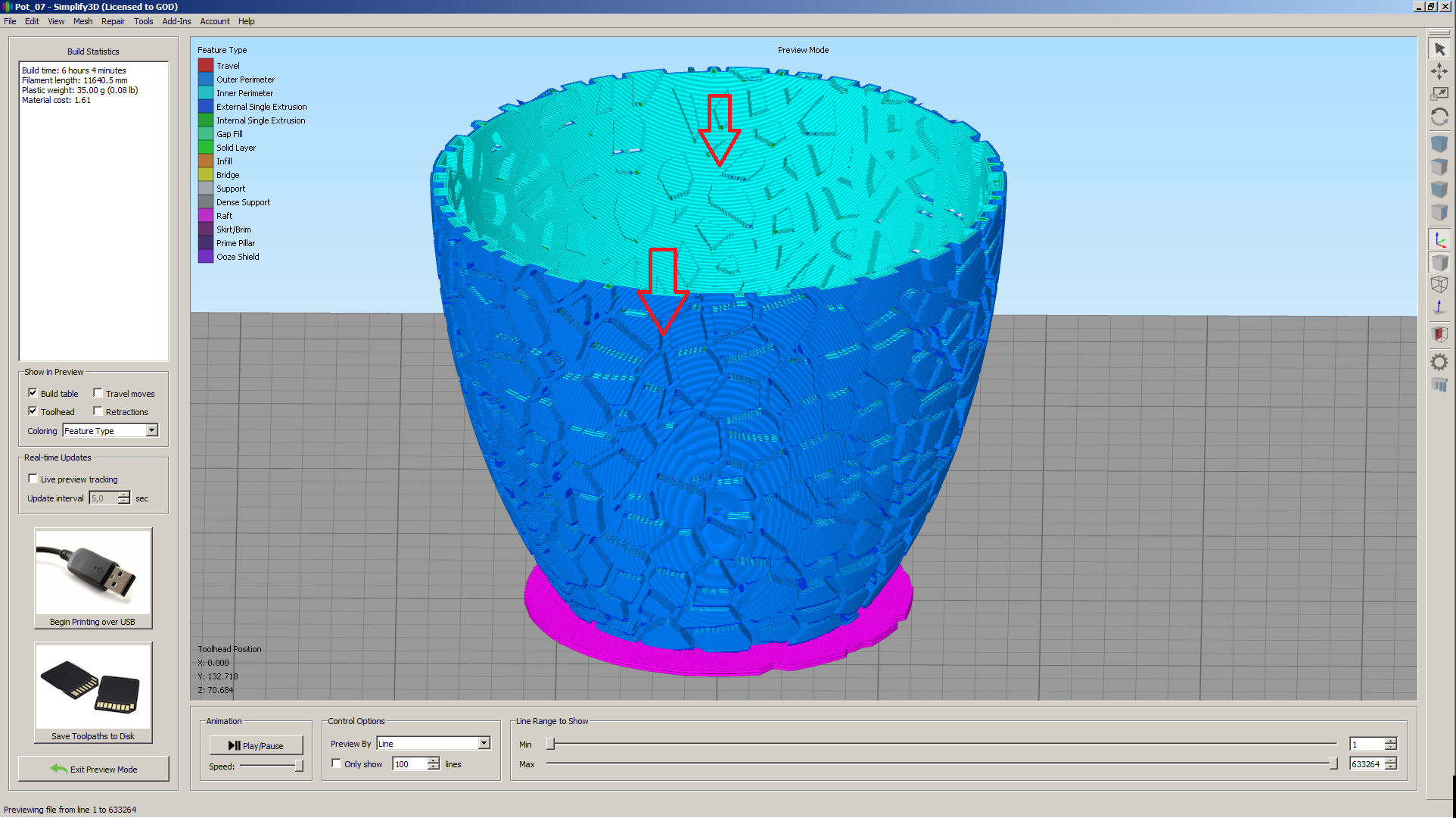

Unfortunately model thickness gives nothing,
I suppose topologi is the key. How S3D distinguish inside/outside of the model ?
Result even worse:

yesbird wrote: ↑Tue May 24, 2022 9:54 am Unfortunately model thickness gives nothing,
If the model does have outward pointing normals all around, like seen on some
of the screenshots, you might consider enabling
"Merge all outlines into a single solid model" on the "Advanced" tab.
This should slice as a solid with the "crackled" structure on the outside... the inside
will likely end up following the zero thickness wall, but this heavily depends on the
object and might not work at all, hard to tell without the STL.

parallyze wrote: ↑Tue May 24, 2022 1:06 pm If the model does have outward pointing normals all around, like seen on some
Thank you, parallyze, but this option is already turned on. I have resigned with low quality inside and ended up with adjusting relief details/scale on the model. For clay it more or less acceptable.

Hmm.... if it doesn't slice as a solid with "Merge all outlines" enabled, then there's probably something wrong with your model file. Try
checking it using NetFabb or similar.

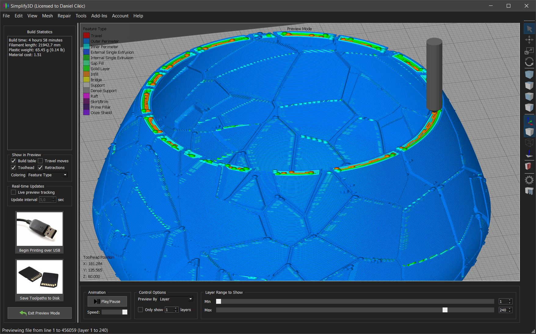

Edit: Just had a closer look again. From the pictures I thought there was already a 0 thickness wall acting as a "frame" inside
your object. But it does look like the fragments aren't connected at all?

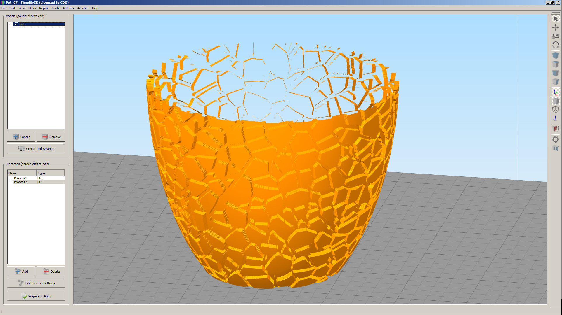

I just tested the approach mentioned earlier in this thread:
1. create object using 3mm walls
2. dupcliate object, thin walls from outside/inside by 1mm
3. fracture thick object using %whatever%, I ran a quick test in blender
4. export fragments, clean up file
5. merge thin walled object from step 2 with cleaned up files from 4
With "Merge all outlines" enabled:
Still seems like a lot of work to do... otherwise all the parts starting mid-air will require supports.... ^^
