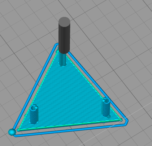

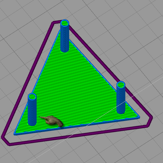

why are thin walls filled?
You can't print it full like that because otherwise it gets too hot and the "tower" melts.
this is a test print.
https://www.thingiverse.com/thing:3093721

Are you saying you want to print the towers completely hollow? Even at the top? That's a little odd, but I guess you could do it by setting your infill percentage to zero and using 0 top solid layers.

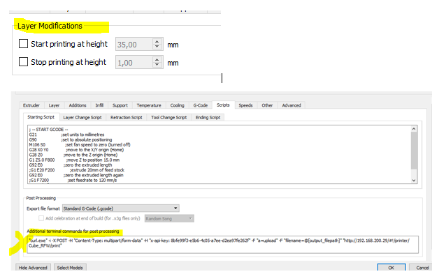

For your other questions, the Layer Modifications can now be found by clicking the "Custom Zones" button in the bottom of your process settings window. The Post-Processing script is on the Scripts tab (it has a whole separate tab now).

S3D-Jason wrote: ↑Sat Dec 24, 2022 3:03 pm For your other questions, the Layer Modifications can now be found by clicking the "Custom Zones" button in the bottom of your process settings window. The Post-Processing script is on the Scripts tab (it has a whole separate tab now).
thank you now i have found the place.
why did you remove the slider for the infill?
you always have to look for the parameter in the tab
I cannot print this part cleanly with s3d.
the "tower" was always scolding because of the forced infill.
with a another slicer the part is not a problem to print.
