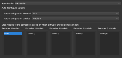

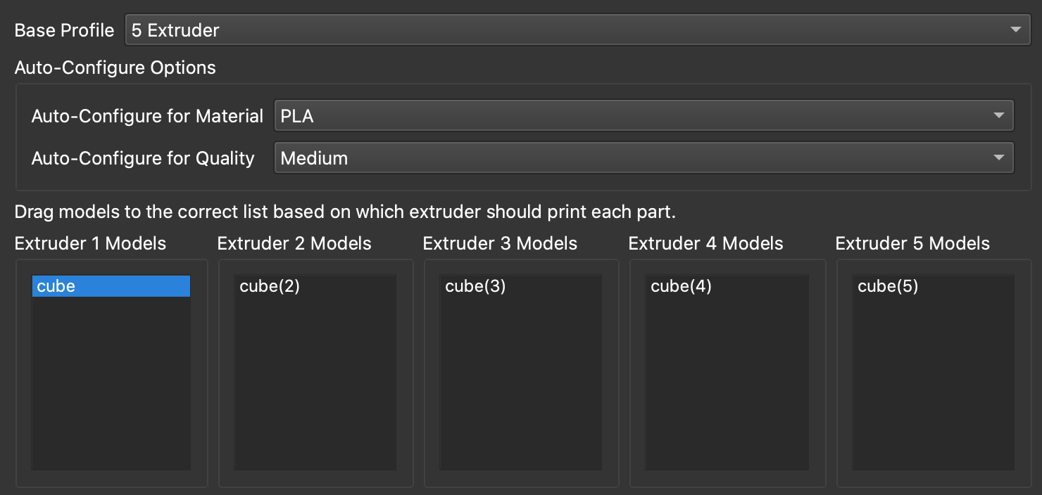

I just tested this myself and it seems to be working. For example, go to Help > Configuration Assistant, choose the option at the bottom to manually configure your machine, and then I updated the specs to say that there are 5 extruders. Complete the wizard, then import 5 different models (1 for each extruder). Then go to Tools > Multi Extrusion Wizard, and select your new 5 extruder profile at the very top. You should then see 5 separate columns where you can choose which model is printed by each extruder.
If you follow those same steps, do you see the 5 separate columns?
