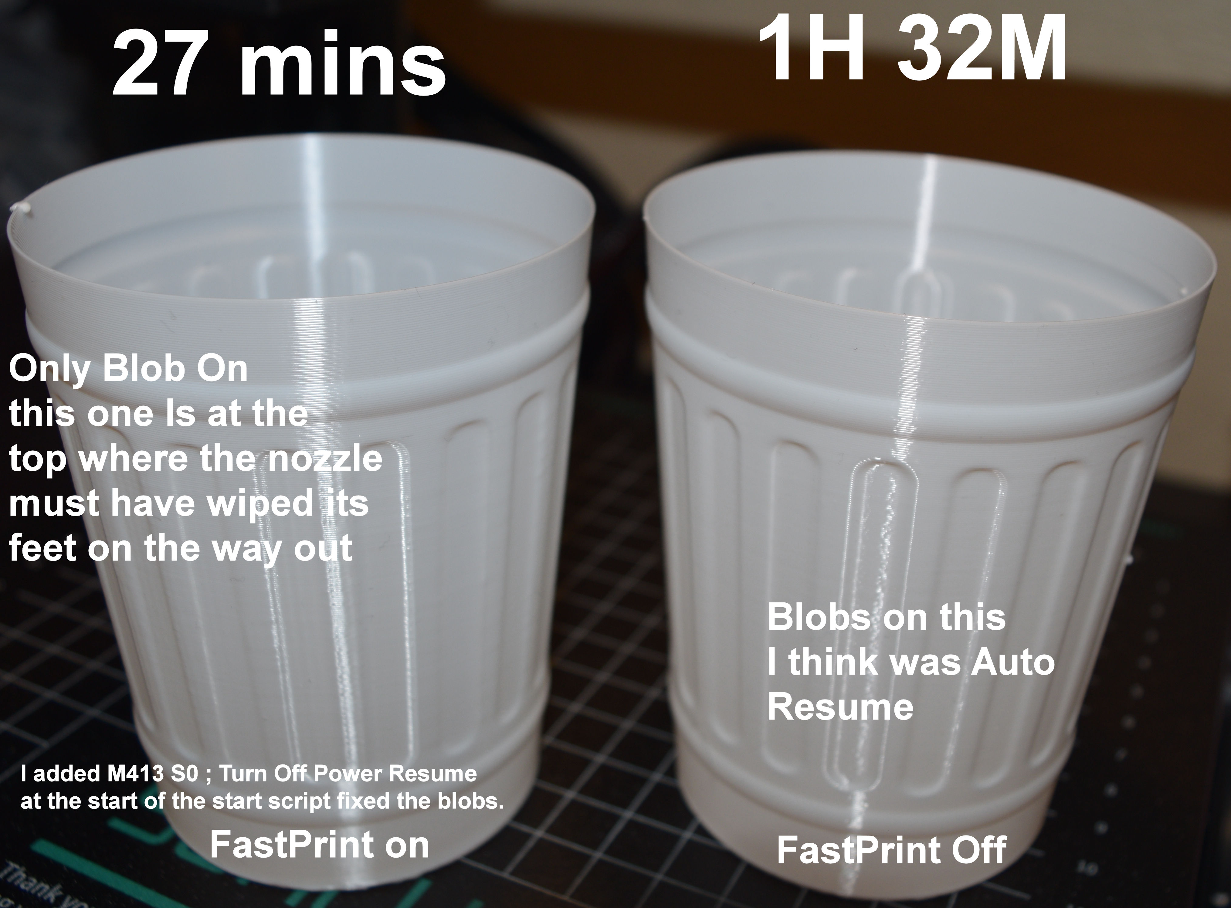

Sa1Wales
Posts: 12
Joined: Thu Jun 06, 2019 11:05 am
Re: SunLu T3 Profile
Still Messing with the SunLu T3 I havent tried pushing it to 250mm/s, As I think fans the would not be able to cool the plasic quick enough and it would warp the shape plus I like keeping detail over speed. But Normal the bin was going to take 1H 32Mins wich the first one I did on time, Then I thought Ill turn on Fast Print and it finished printing in 27 mins and to me I think the 27 min one looks better, On the 1hour 32 min one I still had Power Resume on and I think resulted in the blobs, so I added "M413 S0 ; Turn Off Power Resume" to turn it on in the start script. The blob on the top of the 27 min one, I think the nozzle wiped off the extruded dribble as it went to X0
