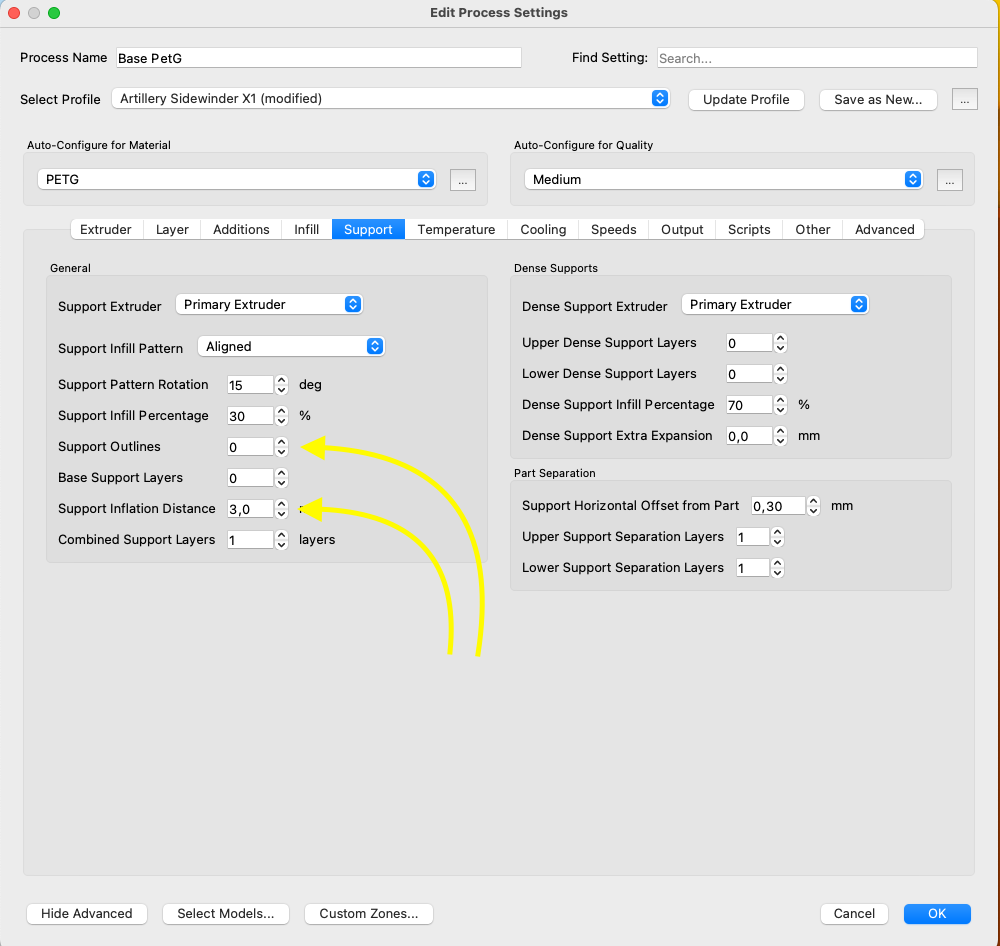

hi guys, i'm happy user of 5.0 version.
recently i work to big size, vertical print, and smaller supports often break or be fuzz.
i tried to add infill, setup stronger infill but nothing
i would like to do bigger support to have more space to manage this kind of situation.

can you provide what you have tried so far? There are ways to increase the size of the support structure as well as other settings that can help but at the moment I only have access to version 4 so the settings could be different or perhaps named different.

sorry i mismatch the meaning of some parameters, i found it.
support inflation distance and outlines give me what i search.
