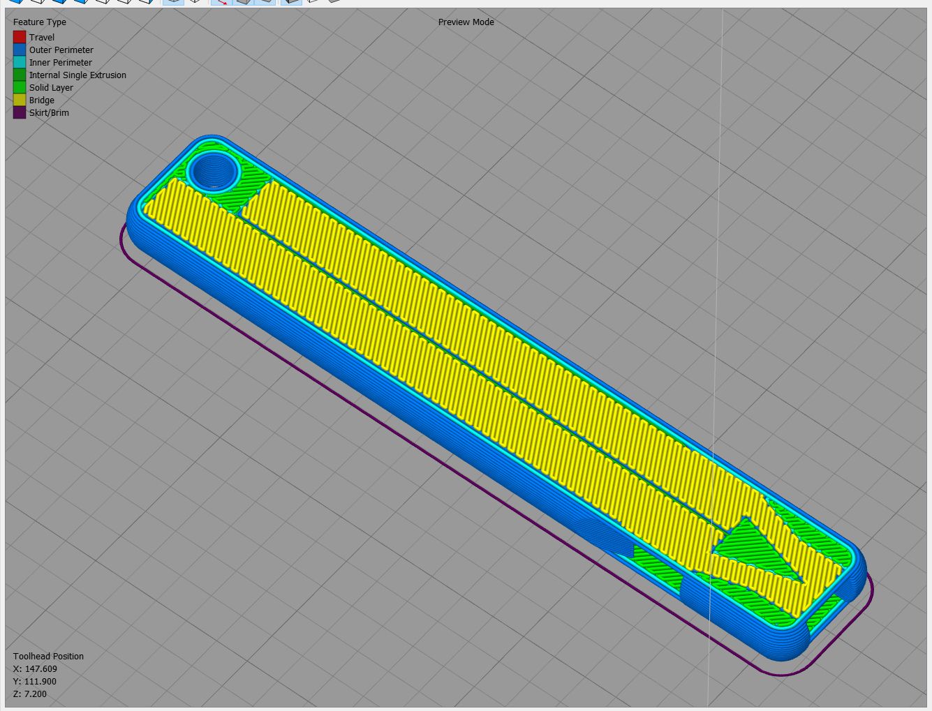

OK I am going batty here. I WANT this layer to be solid. not part solid not in segments SOLID right across no exceptions and it REFUSES to doit
Closest I can get is this

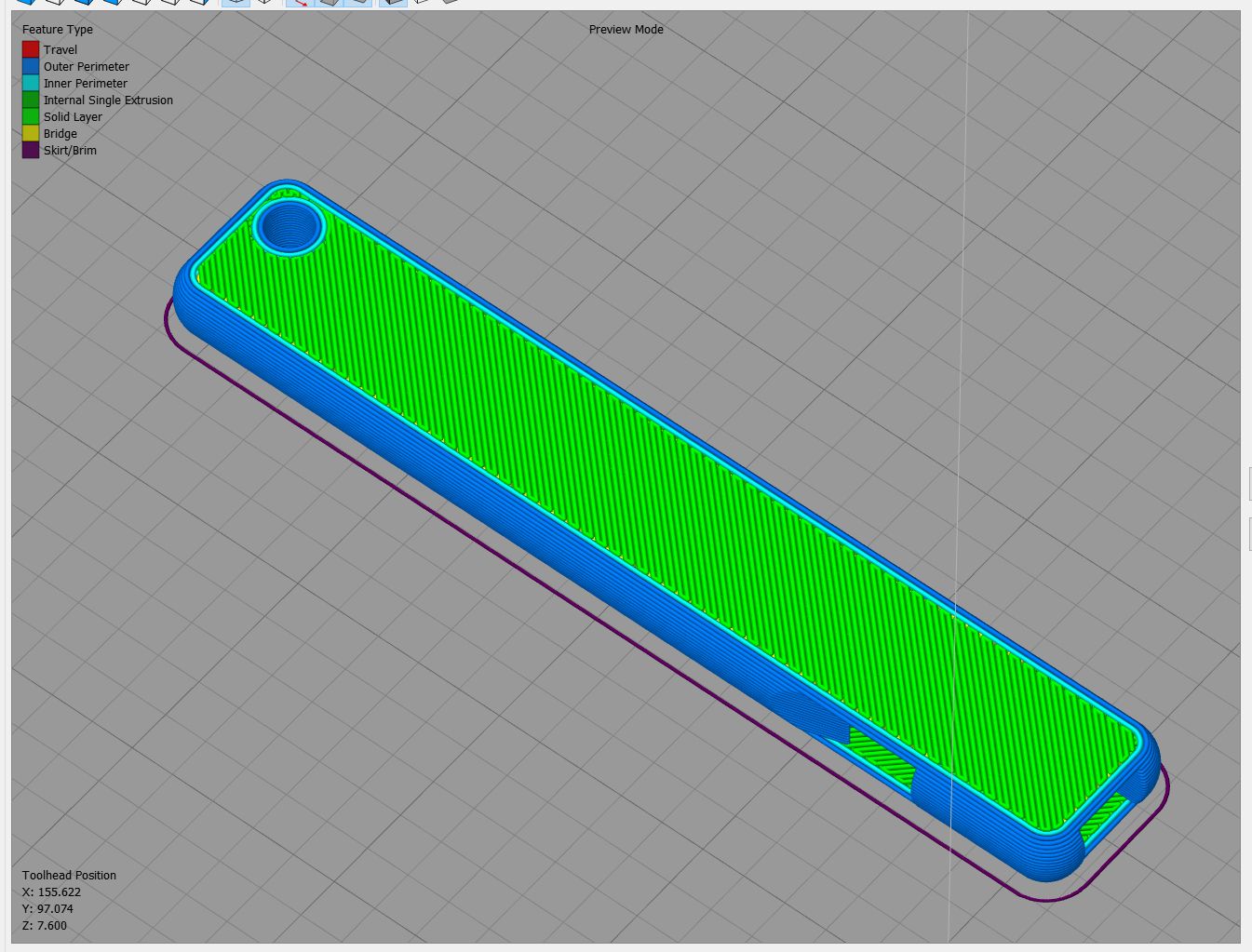

THIS is what I want (this is the next layer)
NOTHING I have changed so far will force this obstinant code jerk to do what I want :-) if it was biological I would have already bitten it. hard :-) hehehe
I created 2 processes. it IGNORES me outright and still does this
I told it to SOLID and HEAL the model. it ignores me outright and still does this
I told it I want a solid diaghram at 7.2mm (this layer) it ignores me outright and still does this
WHAT can I do to force this program to bend a knee to me and do what I want !!! Grrr :-) hehehehe Grrrrrr

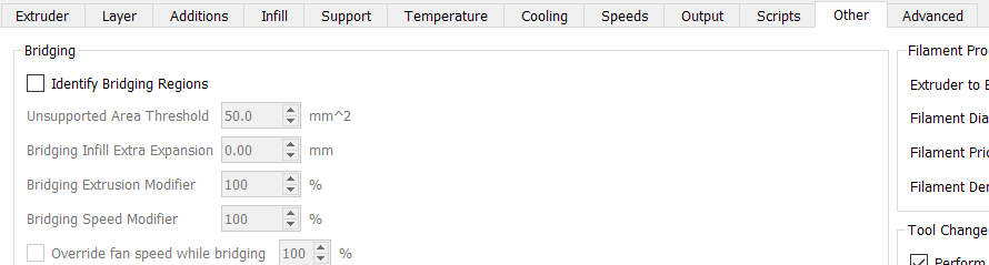

In your process, if you go to the 'Advanced' tab and turn off 'Identify Bridging Regions" your 2nd
last layer from the top will be printed in a solid, uniform manner (S3D won't apply bridging settings).
Since it's a relatively small model, things should "bridge" nicely.
Hope that helps,
D.

Other tab spent a few seconds going huh then saw your image :-)
Thank you. that fixed it. the "small bridges" are guarenteed to fail with a 0.6mm nozzle 0.4mm layers. but a solid layer will work just fine.
Odd setting not sure how to address. its one of those I would never think of bridging but once you see its bridging "of course" it makes sense now.
I still think solid diaghram setting should "override" all other settings in this regard OR it should alert me hey these 2 settings conflict.

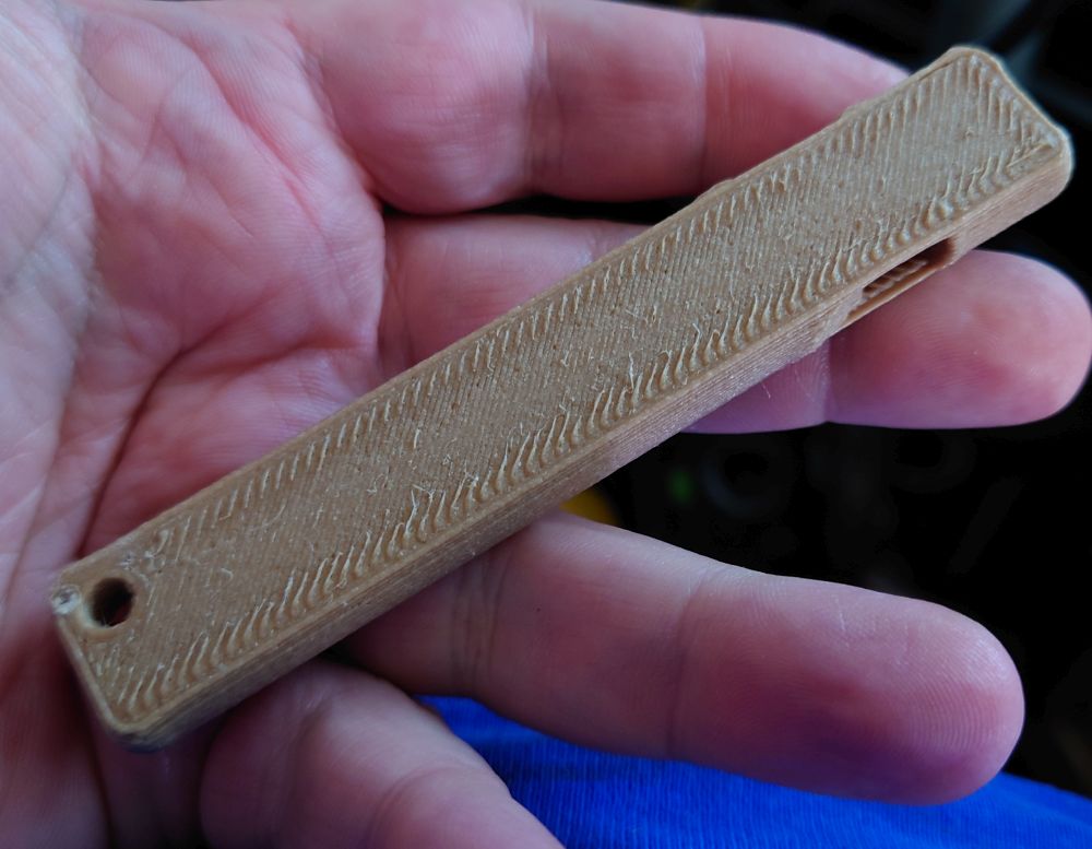

nerys wrote: Sat Mar 04, 2023 6:50 pm DSC_0027.JPG
https://youtu.be/mefFYXXKhMY
That's cool!!! Sounds pretty good, too. :D
