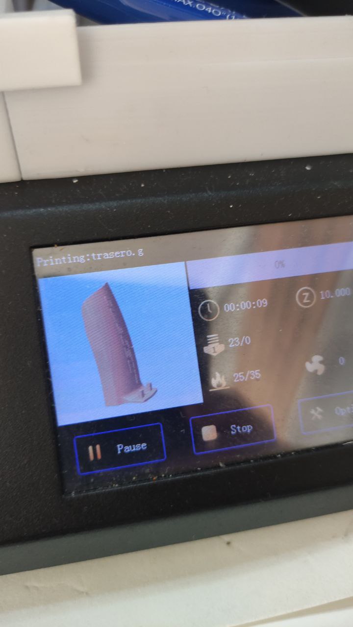

Unfortunately, the print thumbnail does not work on bigtreetech tft 70.
Or am I setting something wrong?

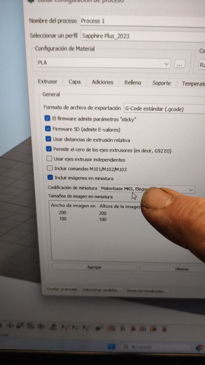

In MKS value to 200x200 and 100x100 see picturesImage

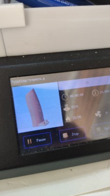

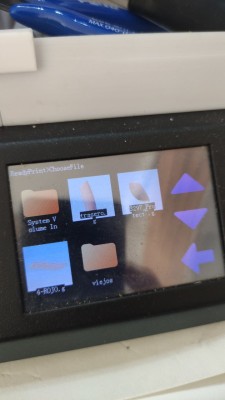

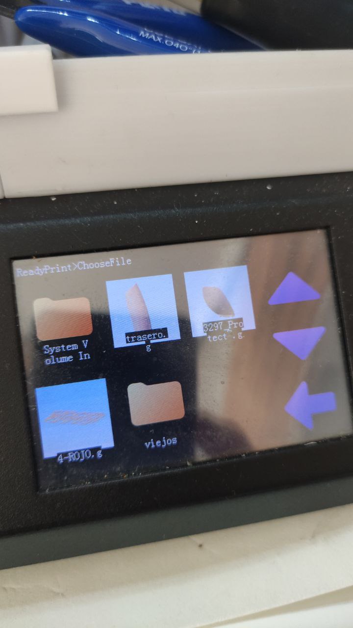

Fixed --- I had to change the settings in the tft display firmware :D :D :D
Now it works fine.
