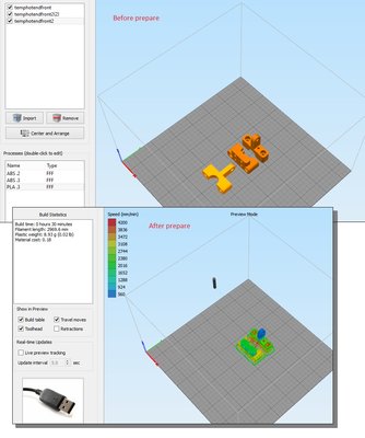

If I import two objects to the print surface it's fine, if I import more, only the first two print.
I've tried various combinations of closing the app, opening the app with items on the build surface, without, adding one item, adding multiple items etc, the result is always the same.
Here's a screenshot showing exactly what is going on.

Click Edit Process Settings > Select Models (in the bottom left of the fff settings window) and make sure all the models you want associated with the process are selected.

habloIngles wrote:Click Edit Process Settings > Select Models (in the bottom left of the fff settings window) and make sure all the models you want associated with the process are selected.
Ok, quick test. This does solve the problem. Going into the process, for some reason it has excluded the last added model. My guess is that, each model added after "Prepare to Print!" is pressed has to be added manually. I have to say I'm not a fan, although I can see how that design decision could have been made given how you can select different processes for different models.
Re: Bug, print > 2 objects
s3d has been like this from the beginning. you have to apply some type of process to each model for it to print and since you can apply a different process to each model, at some point you will need to choose what gets applied to what. its a very easy thing to over look and many people have posted this same question so your not alone but i dont know of any other way it could be done that would be easier. once you know about it though its really no big deal and you'll always remember. just part of learning the software i guess.
