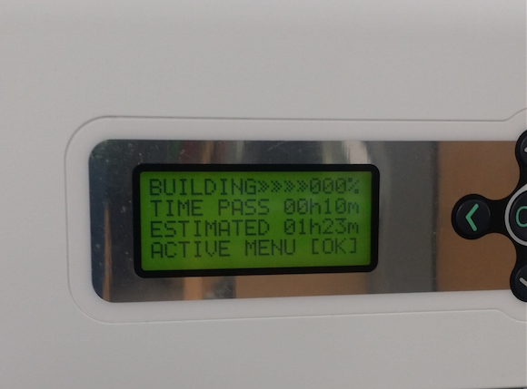

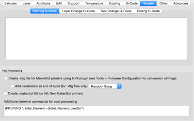

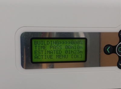

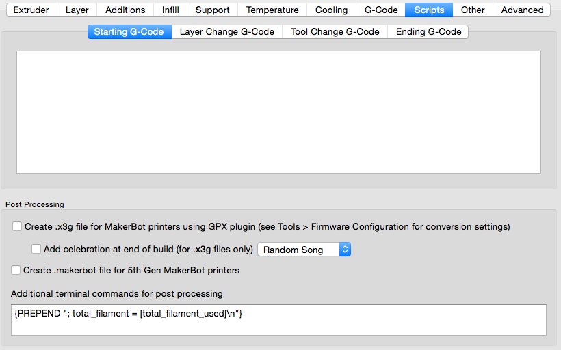

I was under this impression as well, however, it is printing fine on my da Vinci 1.0a without adding any additional header information, just imported a model, sliced, and uploaded to the printer directly from s3d
