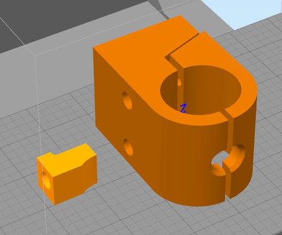

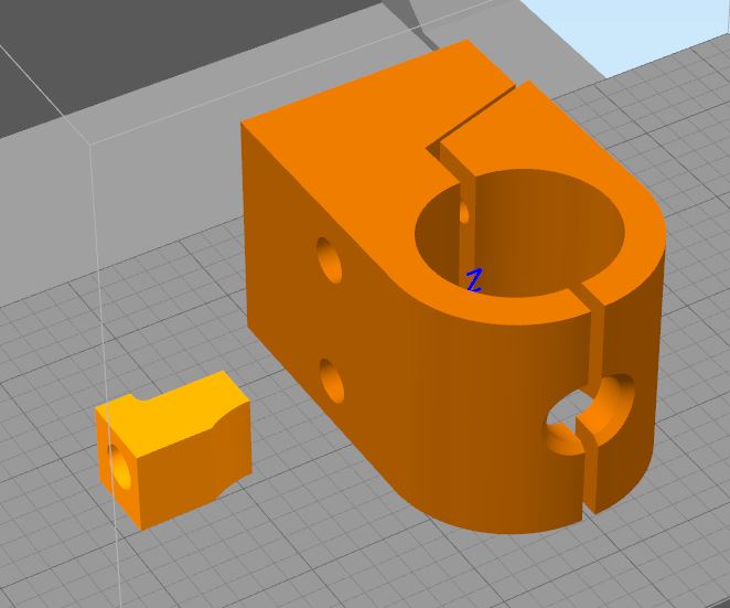

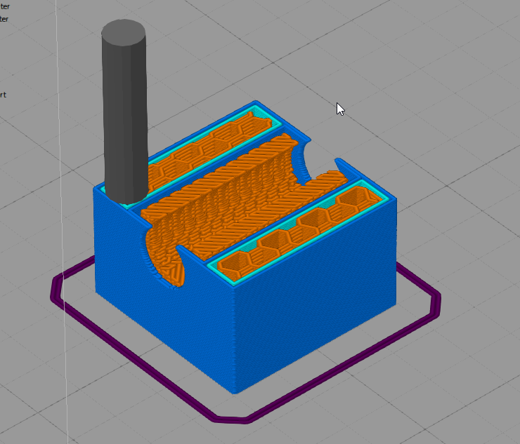

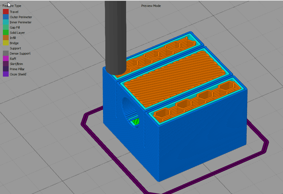

I cut a part of the 3D-Model out which I wanted to print with 100% infill (Image #1). Then I moved it in the whole model to the right position and created a process for the small part with 100%. But when I sliced it, the slicer prints the infill of the big part in to the 100% infill part (so it is printed 2 times, Image #2).

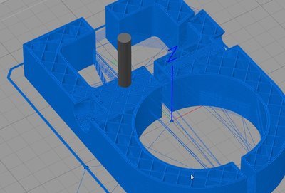

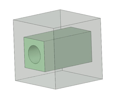

Then I cut the small part out of the big part and tried it again, but then I get a gap between those two parts (Image #3).

This is what I did in the third image, but then I get the scar and no single outline. S3D don't want to merge the outlines together. It acts like it is multicolor (of cause S3D could not know what I want, but it could guess because I use the same extruder.
Of cause I can cut out the part in the model and leave a 0.8mm wall, so I have a continuous outline, but this is way to much preprocessing.

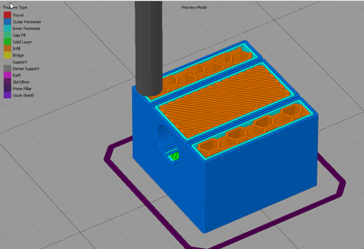

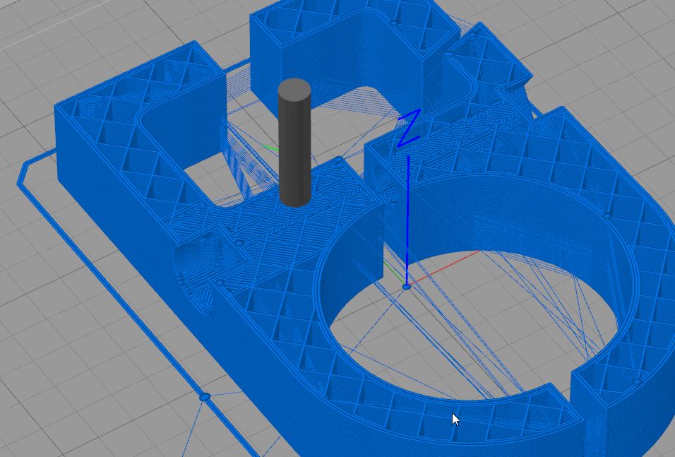

So here is my result. As expected still the same
My design:
Print (with scar, since each process has its own outlines):

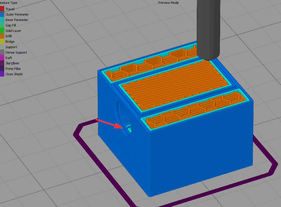

And here is my more time intense workaround, by give the outer cube a 0.8mm wall infront of the inner part. But then a scar is stil there but on the inside

Of cause I can do a 0.8mm wall as tube in the outer cube too. But well how much time should I invest in designing to get it work? Ten times more? This is definite not an acceptable solution.
This is the photoshoped version how it should look like:
