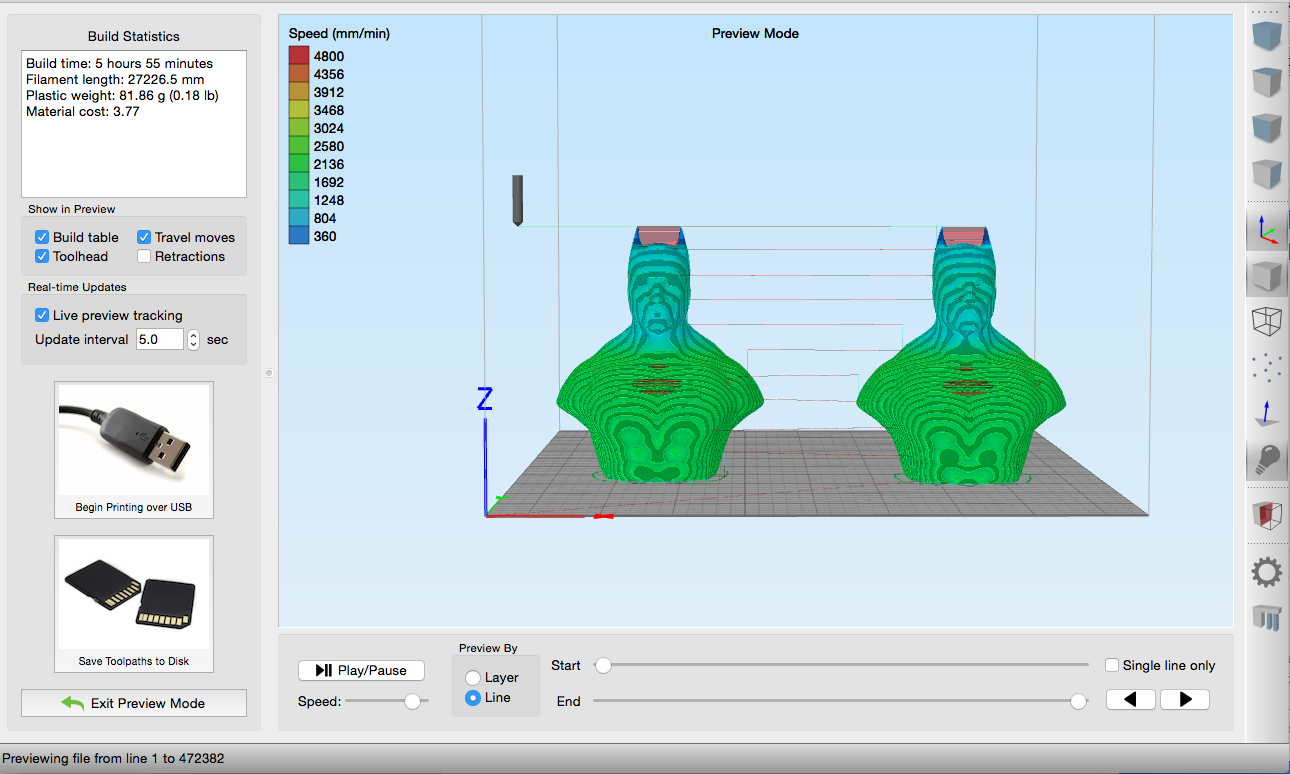

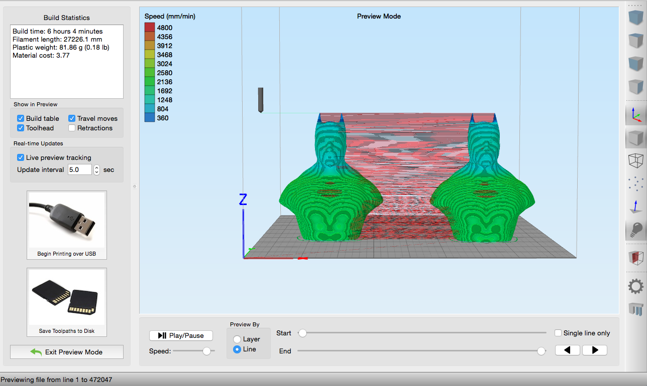

3.Sequential printing:

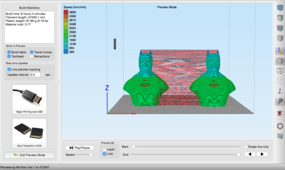

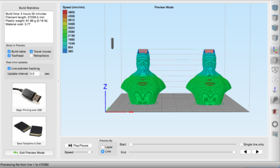

If you're printing two parts on your bed 100 mm tall (approx 4 inches), at a .2 mm layer height it will require 500 layers. With sequential printing on, you can decide you only want to move from model to model once every 10 mm, instead of every .2 mm. If you have more parts, on a bigger bed, this feature will be even more useful. To use this, you setup for a multi-part print by making each part have it's own customized process, then after clicking Prepare to Print! the software will prompt you whether you'd like to use sequential printing or continuous. http://www.simplify3d.com/support/tutor ... -printing/
