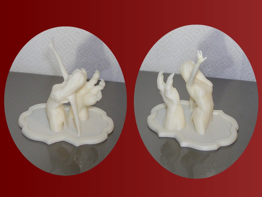

My First 1.1.3 Print
So what are some of you guys printing?
The Escape
The Escape

Re: My First 1.1.3 Print
That came out super clean.
August
Joined: Sat May 11, 2013 7:53 pm
Wow! Yes, super clean! My results have been very disappointing thus far. If you wouldn't mind, I'd like to know what you've done setting wise to get that quality of print.
slipshine
Posts: 86
Thanks - Glad you liked it:
It was printed with ABS plastic on a Makergear m2 factory built.
I am attaching my .fff for the settings and a text file with the settings if you don't have Simplify 3d.
m2-150-abs.fff
(2.49 KiB) Downloaded 412 times
settings.txt
(3.13 KiB) Downloaded 466 times
One important things if you are printing this specific project.
I print a 1/2 inch diam tube the same height as the model right beside it.
This lets the layers in the arm and hand cool before the next layer.
Hope this helps.

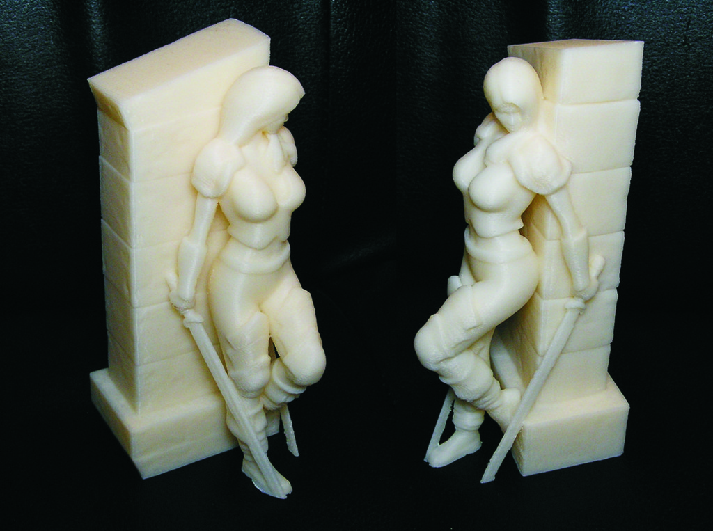

This is another print done with the same settings.
http://www.thingiverse.com/thing:68741
Great Model from Fantasygraph
