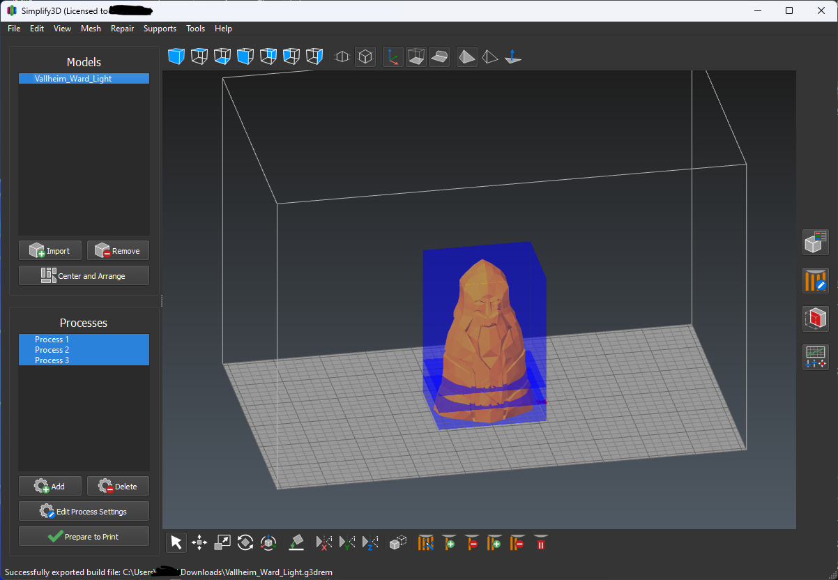

IhatemyISP
Posts: 5
Joined: Thu Apr 05, 2018 2:55 pm
Re: Pause for Dremel 3D45
SgtJon wrote: ↑Tue Nov 07, 2023 7:09 pm What I am asking for is that the command that the s3d issues at "End Printing" is replaced with the 3d45 pause command.
I know this might be a little late but....
If I'm understanding this correctly, you're wanting to do the following:
  1. Use multiple processes to print a model
  2. Each of those processes is using the custom zones to specify print start/stop heights as necessary
  3. Between each process, you want S3D to have a G5 command issued (I'm assuming for you to change filament or something?)
If that list is correct, I believe I have a solution for you.
  1. Add all the processes you need, specifying the print start/stop heights and other settings as necessary.
  2. For each process after the first, in the "Scripts" put just "G5" in the "Process Change" section
  3. Click Prepare for print
  4. Read this a couple of times and determine which printing mode you need/want.
  5. Click "Select All" for the processes (ensure all processes are highlighted).
  6. Select your printing mode and press Ok
  7. Follow your normal S3d to Dremel printing workflow
While I don't have a Dremel machine to test this on, I can verify the Gcode. There are three processes total giving two process changes and two "G5"s.

I really appreciate your suggestion, Sadley S3d will only accept a single process at a time, therefore
there can be no "Change Process."
