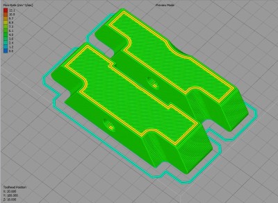

The scale for MVS is from 0 to 96 on my version5
It can not be used if the scale so high. Think more normal will be 0-25mm3/sec
I set MVS in speed tab to 11mm3/sec and the scale have not changed.

myprinter wrote: Thu Dec 14, 2023 2:00 pm The scale for MVS is from 0 to 96 on my version5
Are there any purges/extrusions inside the starting script which might explain the 96.3mm³?

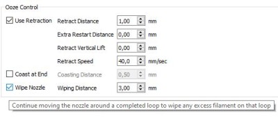

Problem is retraction, one more bug in v5. If disable retraction the scale is normal, when enabled the scale is wrong.

It is the Wipe Nozzle bit there make the problems. When disabling it all is nice.
