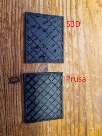

I had already asked about this elsewhere. I print at 150 mm/s. Simply changing the “Default Printing Speed” is not enough. For example, no good support structures will then be printed.
I believe that the "Neptune4 profile" was never tested by you on a real printer.

We don't release a profile until it has been tested. So yes, the Neptune 4 profile was definitely tested and I know for a fact that we have many other customers using it successfully.
Looking at your photos, it definitely seems like there is something else more significantly wrong than just speed settings. Can you post the 2 gcode files that you printed for those tests?

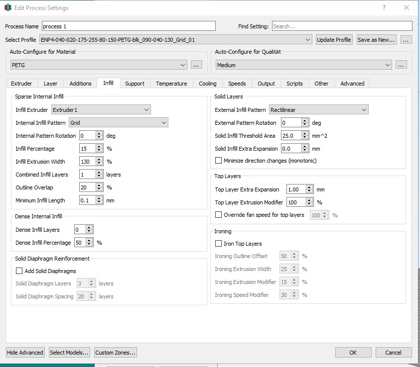

I had already increased the printing temperature by around 10 K before.
I helped myself by increasing the "infill extrusion width" to 130%. I had to reduce all other speeds to the values for a normal printer at 60 mm/s.
Another disadvantage is that you can not simply change the "Speeds" to "Percentage" or "Absolute", as is the case with the "Layer Units".
That's pretty much how it works. But I don't know if this is all right and optimal. But that's what I expect from a professionally created profile. Nobody buys a printer that can print up to 500 mm/s in order to print at 50 ... 60 mm/s, as the "Elegoo Neptune4 profile" provides. The people at S3D can't expect me to have to use other software to get the data for S3d. I simply don't have the detailed knowledge, especially since the terms are not standardized. As a precaution, I don't try higher speeds above 150 ... 175 mm/s with S3D.

Ah, I see. So the photo you posted above is from the print you had done where the 2 software were printing at very different speeds?
In that case, I think it might be best to wait and hear from the OP to see what his experience has been. You can continue discussing your issue in the thread you already created since we've already provided a few suggestions there.
