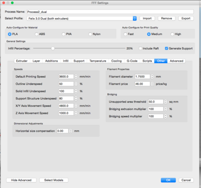

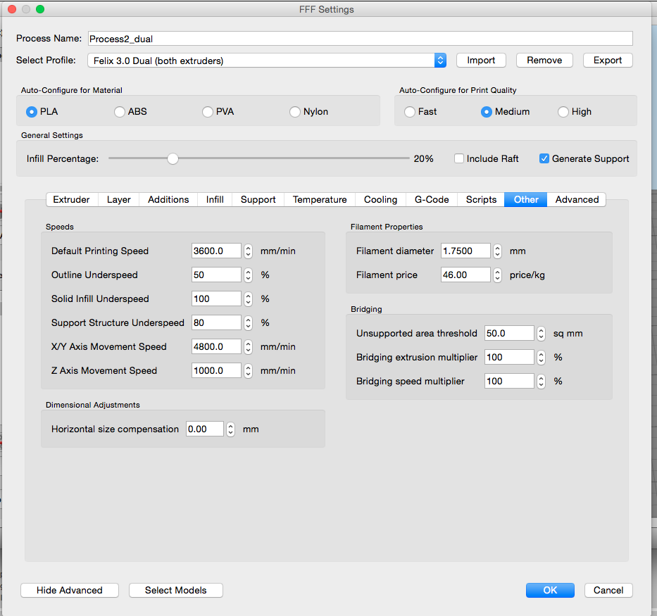

KeyboardWarrior wrote:Bridging Speed multiplier:If you find that printing faster/slower helps with bridging, then you would set that here. One trick I use occasionally, is I'll temporarily set the bridging speed multiplier to 999, then slice my file, that way the areas in which the bridging multiplier is taking place are bright red and stand out in the G-Code previewer, that way I have a better idea of where the bridging settings are occurring.
A handy trick that KeyboardWarrior shared last week was to use the bridging speed multiplier to make areas where bridging will occur plainly evident in previewer mode. http://forum.simplify3d.com/viewtopic.php?f=8&t=2363
You could then use this information to setup a separate process exclusively for the layers on which bridging would occur. Use whatever outline overlap you'd like in that process and then make a third process to resume with the original settings once the bridging layers are done.
if you need help using multiple processes on a single model theres a tutorial for that! https://www.simplify3d.com/support/tuto ... f-a-model/

I tried this trick on the bridge torture test model from thingverse but it is not changing color to red so i assume it is not using bridge settings on this bridge. any reason why it wouldnt?
Re: Bridging outline overlap
jamieb wrote:I tried this trick on the bridge torture test model from thingverse but it is not changing color to red so i assume it is not using bridge settings on this bridge. any reason why it wouldnt?
Because your bridging area threshold is too low. When you are printing smaller parts with tiny bridging regions, you may need to lower the area threshold. It won't try to bridge anything that is smaller than that threshold area.

This feature was added in version 3.0. There is a new option on the Other tab called "Bridging extra inflation distance". This will expand the bridging region so that it has more overlap with your outline which can help it print better with more of an anchor, as you mentioned.
