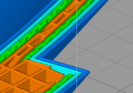

Hi does anyone know what setting I have to change to make the infill connect to the perimeter walls and not have the green solid layer between walls and infill. This only seems to happen on prints where the walls are not vertical.

The mix of different printing patterns in this particular model is due to it being an overhang, and the solid layer patterns are printed together with the perimeters. In our internal testing, it usually results in stronger parts.
If you would like the solid layers only at bottom and top, you could create an additional process that is added in the middle via Custom Zones (bottom left of Edit Process Settings), that has the setting of no top and bottom layers.

Thank you that seems to work
