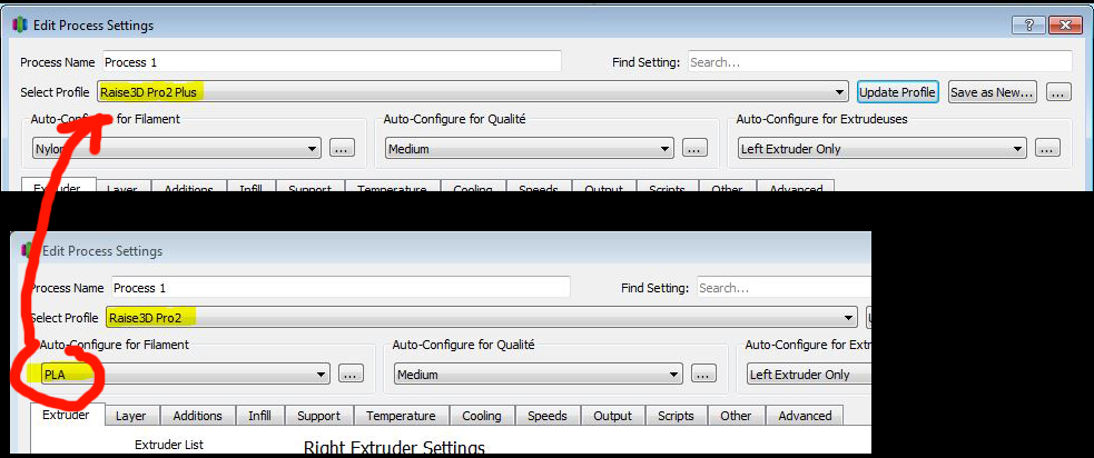

Copy "Auto Configure For Filament" profil to another printer profile
Bonjour,
I would like to copy the settings of a profile "Auto Configure For Filament" into a new printer profile. Is this possible please ?
Thank you
Re: Copy "Auto Configure For Filament" profil to another printer profile
I don't think there's a UI option to copy settings between completely different profiles, but you can always go to File > Export Printer Profile and export both profiles to a XML file. Then if you look at those XML files it should be easy to copy what you need from one to the other.
