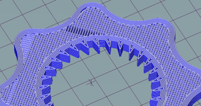

Bonjour,
J'ai un fichier pour lequel il y a des manques.
Sur cette photo, on voit qu'il manque une dizaine de lignes...
Il y a plusieures zones comme celle-ci sur ce fichier, même sur la dernière couche.
Pourtant, le fichier gcode semble OK.
Hello,
I have a file with some missing information.
In this image, you can see that about ten lines are missing...
There are several areas like this in the file, even on the last layer.
However, the gcode file seems to be OK.

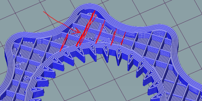

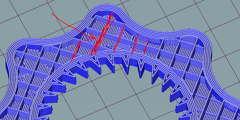

Looks like a bug in the software.

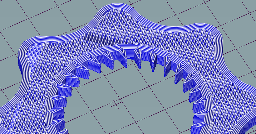

I tried a lot of different settings so the results were somewhat close to original. After slicing, the file looks good in simplify3d but I exported the Gcode file and imported it into Repetier Host and you can clearly see that it will not print correctly. It looks just like your picture.
Rotating the part
Scaling the part
Different nozzle diameters
Repair triangles
More/Less outline perimeters
Layer heights
Infill percentage
Mesh repair
These are just a few of the many things I tried without any success.
The missing lines/walls will change location with different settings.
First screen shot below shows missing vertical walls.
Second one shows similar to the original post.
