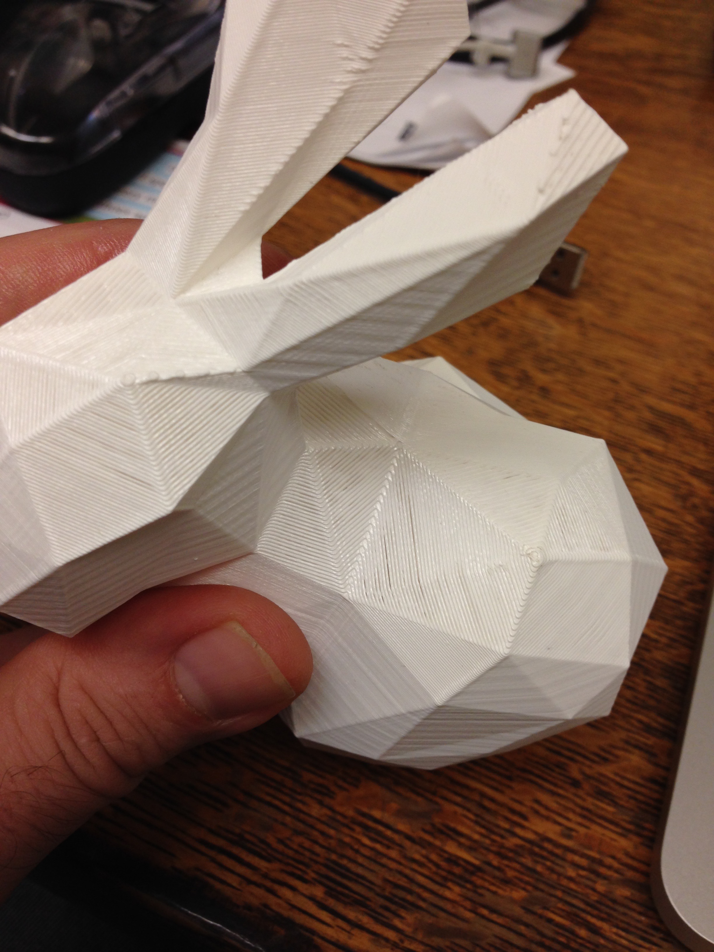

S3D 3.0 settings question- TAZ5
I'm trying out 3.0 on the TAZ5 using this standard bunny model test & there are distinct separations of the outer perimeter layer. This only occurred in flatter angled slopes. I was printing 3 perimeters @ .2mm layer height, infill was 15% and the extrusion width was .4 (.35 nozzle) @ 100% flow rate. I feel like the separations shouldn't be here. It almost looks like only 1 perimeter was created in these areas. The vertical walls look great and am pretty sure there is no extrusion idler issue. Not sure what else to change to make this look better.
KeyboardWarrior
Re: S3D 3.0 settings question- TAZ5
It looks like you may very slightly be under extruding. I would recommend raising the extrusion multiplier value in the extruder tab.
