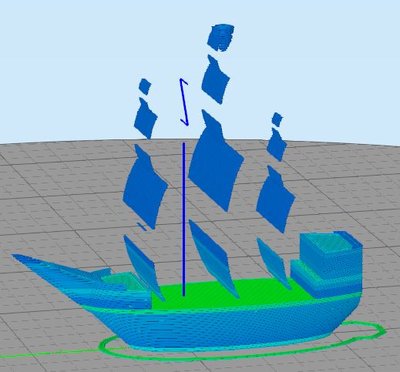

I have been using the Cura engine within Repetier Host for about 6 months before I decided to purchase Simplify3D. I have had issues with Cura not generating thin walls. Simplify3D seems worse. For instance, the attached file of a Pirate ship.
pirateship.stl
(1.1 MiB) Downloaded 589 times
With a .4mm nozzle, I can get the sails to print with a magnification reduction as low as 67%. Simplify will not print the sails at any magnification lower than 81%. Anything lower than the stated percentages in each program cause the ship's sails to disappear. is there any way to get Simplify 3D to at least perform as well as Cura, if not better?

This isn't a bug, but it is frustrating. The problem is that simplify doesn't try to print features that are thinner than the extrusion width. You can try to reduce your extrusion width, but this is generally tied to your nozzle width. Reducing it may have nasty side effects, but you'll just have to play with it to see if its livable.

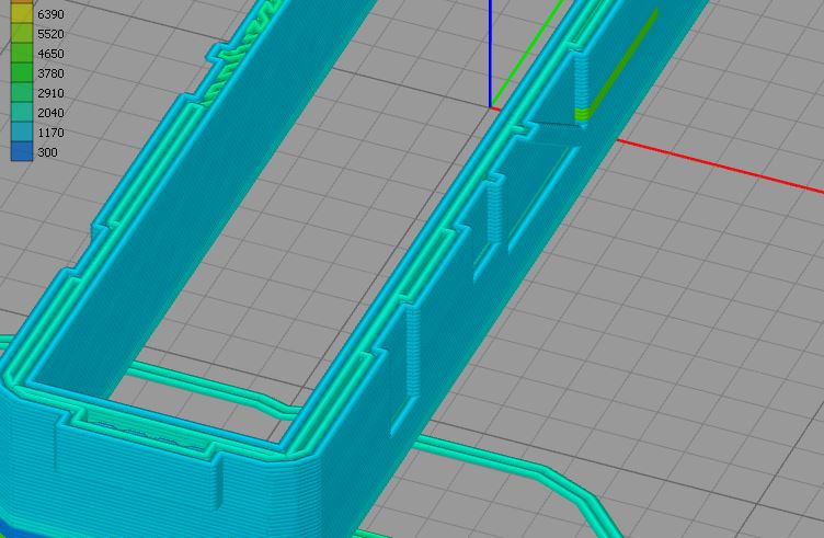

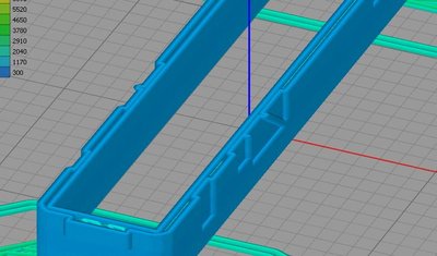

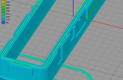

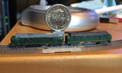

Thin walls is a subject I always have to take into account when designing the sort of things I want to print. Here's an example I have successfully printed using a 0.4mm nozzle with 0.05 layer thickness:
Note the size compared to the UK £1 coin! btw This is T Gauge scale model railways!
Here's an illustration of the thin wall effect....sliced as printed above:
Note that I've had to make the wall thickness 2.5 times the extrusion width to get the indented detail. And I've had to make sure I leave room to get a single extrusion in in between the indentations.

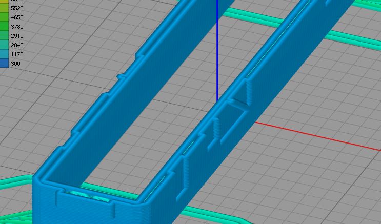

I'll soon be trying a 0.2mm nozzle, which should give a bit more "elbow room" where thin walls are concerned. Here's the equivalent simulation:
