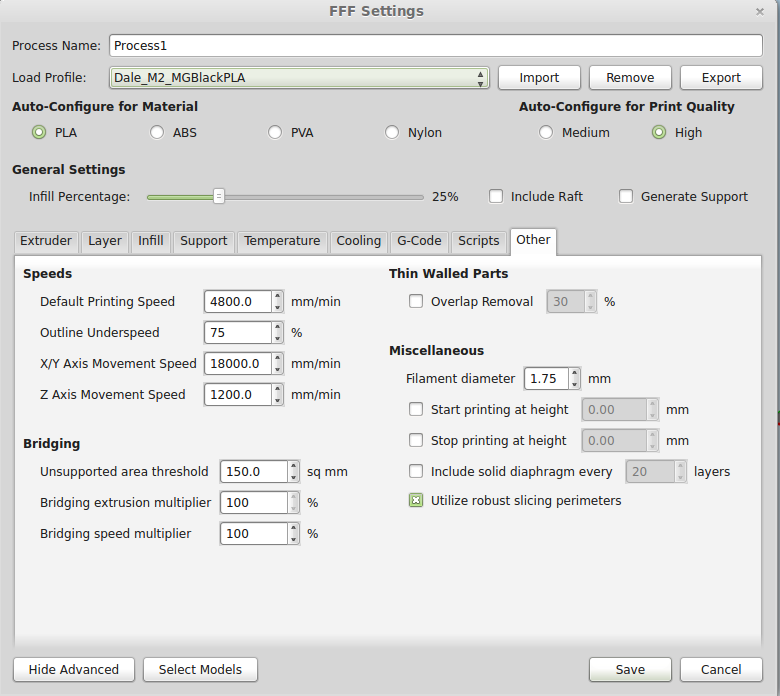

My rapid moves are way too quick and I would like to slow them. I have been over riding the file from the machine control panel using the over ride settings the rapid moves are good but then the actual print moves are way to slow
See the attached screenshot. In the FFF Settings window, show the "Advanced" stuff, then go to the "Other" tab. There are the speed settings. The "Default Printing Speed" is the X/Y motion speed when extruding (unless you override, like on the first layer, outermost perimeters --- right below it as a percentage of that speed --- etc.). The "X/Y Axis Movement Speed" is the speed for non-extruding rapids. This is the one you want to reduce.

FFF Settings, Advanced settings showing, Other tab, showing printer speeds
