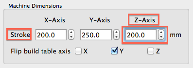

It's called stroke in Creator. Go to Tools > Options (or Preferences on a Mac) and look at the right-hand side. The Z-axis stroke is what you're looking for. By default it's setup to match the M2 dimensions.

I do not have a 'Stroke' option. I see a panel with machine dimensions, and a z value of 200mm. I was hoping for a way to set the starting z height in the gcode. Some times it is beneficially to tweak this for different colors of material, and such without having the adjust the machine itself. For minute adjustments, like .1 micron here and there.

The Z-stroke I was talking about defines your build volume height (see screenshot)
