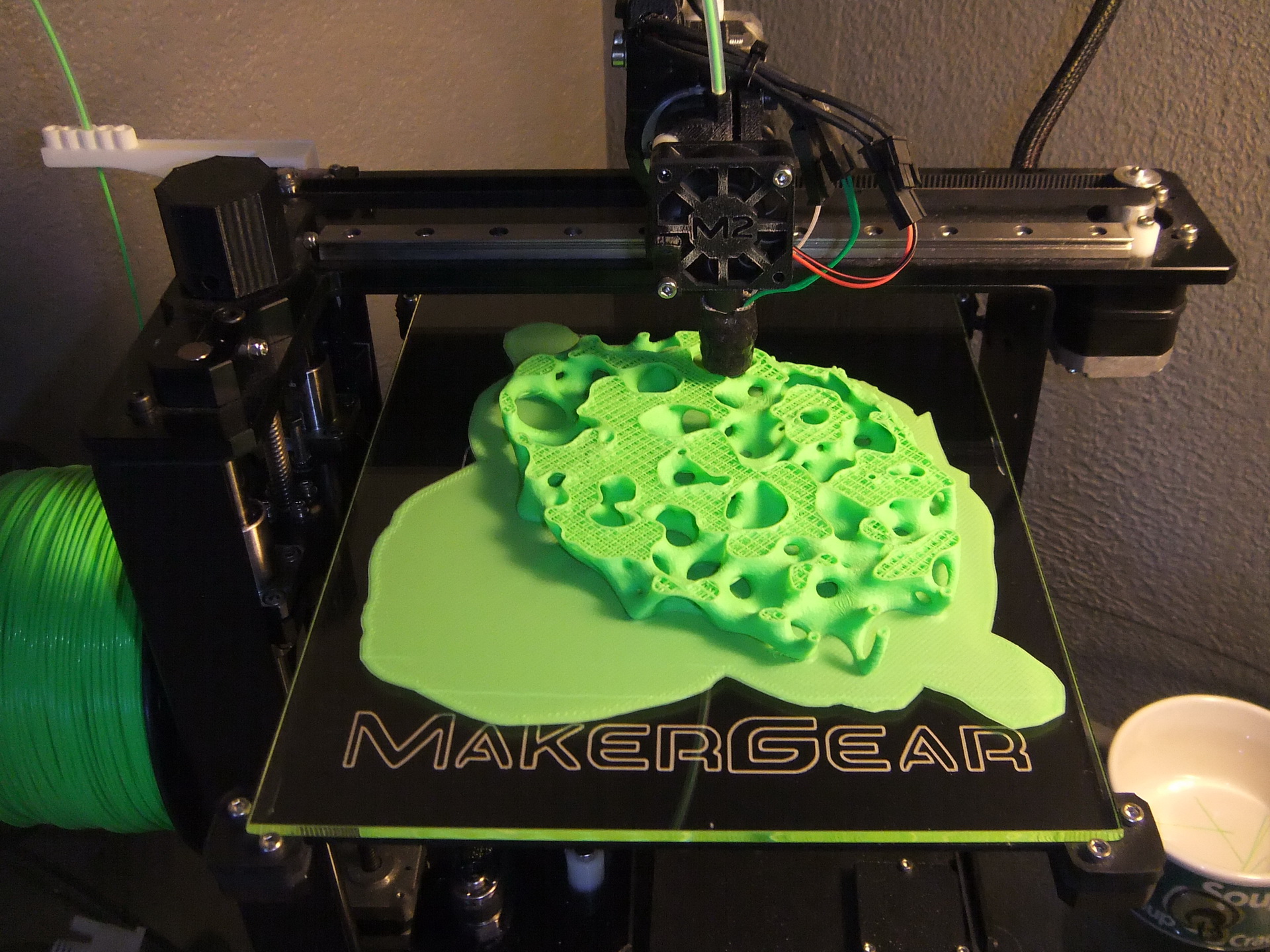

Here is an image which demonstrates the large unnecessary raft:
So much wasted plastic. (And it also takes away from how big I can print the object.)
Re: Bug? RAFT seems to consider more than the object's base
i see what you mean. that print in the pic looks funny. looks like a pile of ooze melting into a puddle.

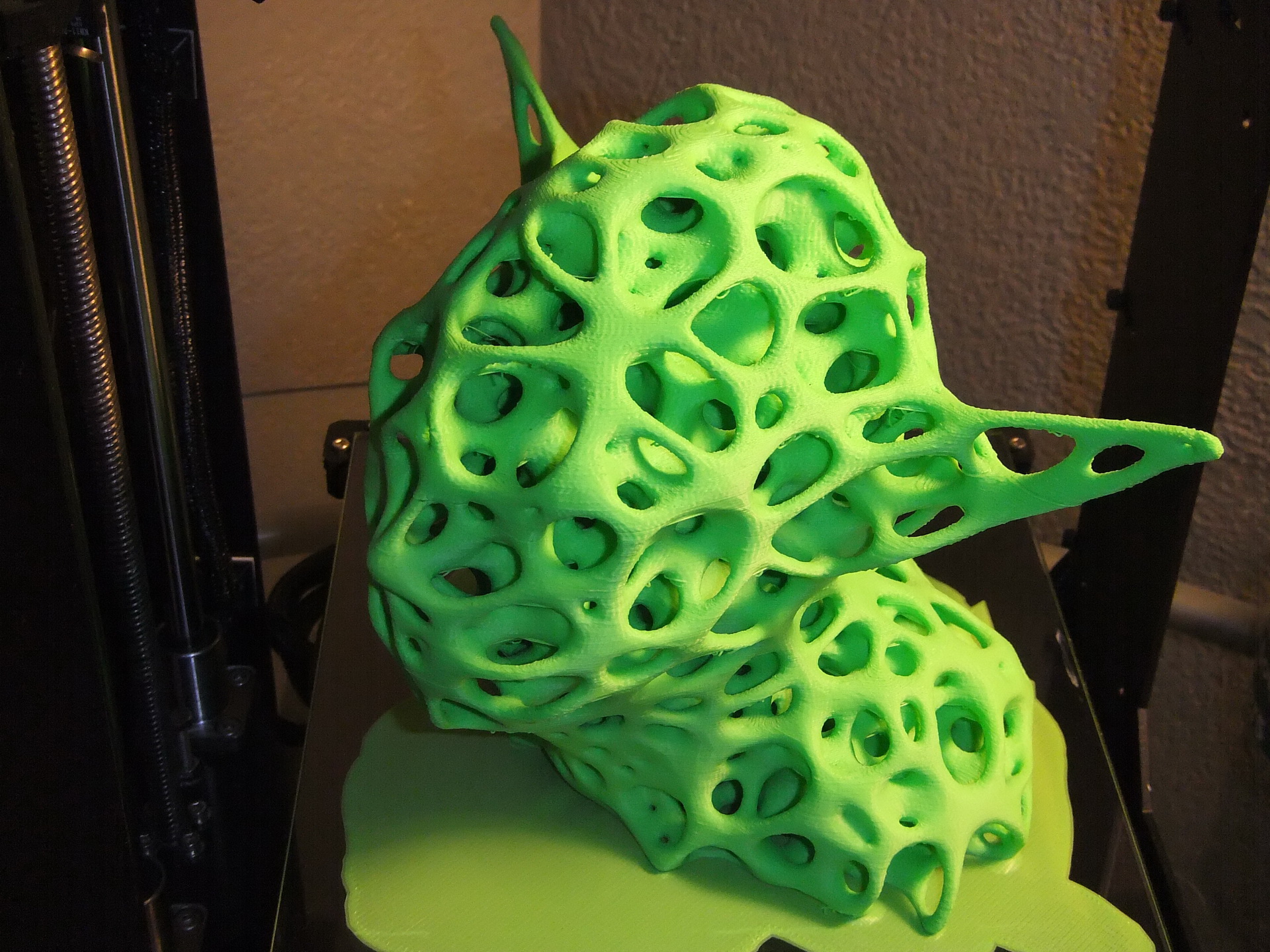

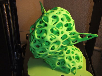

Finished. 24 hours, 20 minutes. I have to clean up the print -- it wasn't designed for clean 3D printing. There was a lot of bridging going on. This thing stuck to the borosilicate glass so tight that I had to rest it in the deep freezer to get it free. (And people seem surprised when I say that I print ABS directly to glass?)

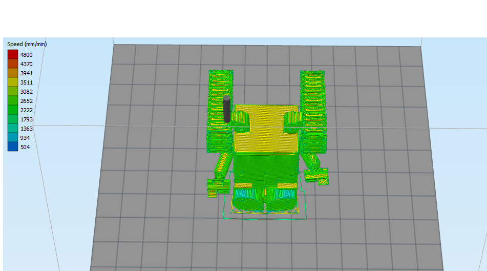

Hi all,
I used a random part to show my simple solution for small rafts just divide the print, see picture and factory file.
Wall-E_Scaled.factory
(751.89 KiB) Downloaded 538 times
