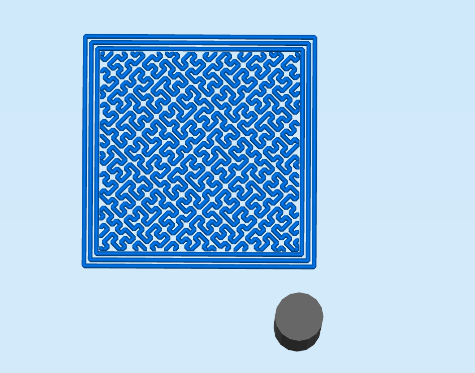

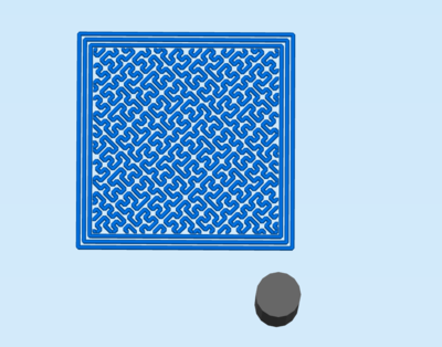

I sliced a cube in Repetier and loaded it in the Gcode previewer. This is using the hilbert function for the exterior infill pattern. I think having all the empty space allows the filament to contract uniformly, whereas with rectilinear it would contract more-so in the Z-axis (warping off the bed).

Interesting... never thought about using the space to help with warping. I've always thought it was the upper layers contracting which pulls the print off the bed.
To generate extra space on the first layer, maybe a higher first layer width... unless they fixed in 3.0.2...
