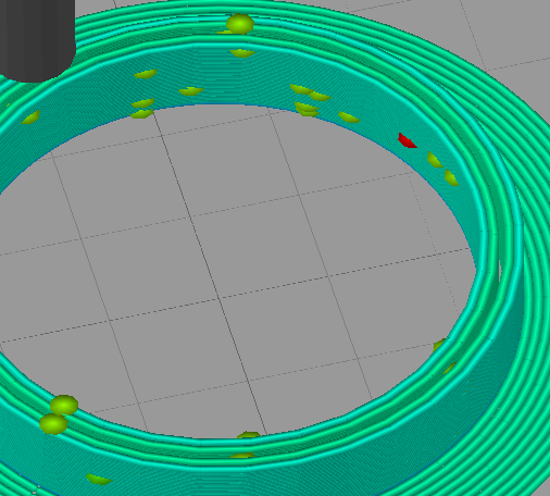

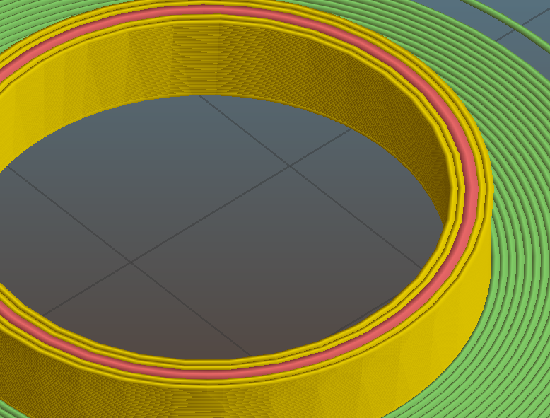

i have switched from Slicer to Simplify. But i have some troube with gaps in my walls.
In Slicer i have set 0.4mm Nozzle. My part is fine:

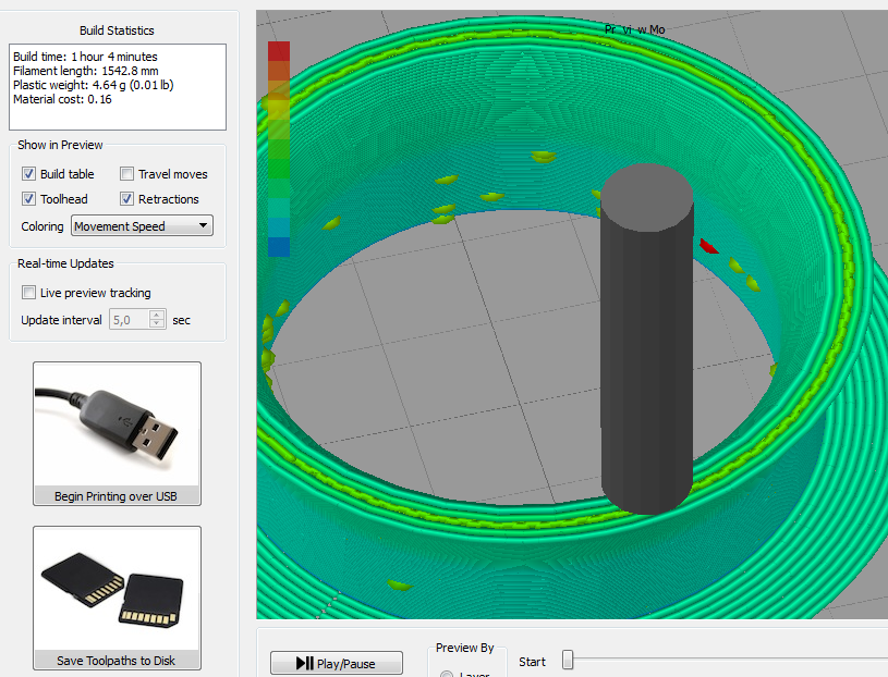

but when i do this in simplify i have a gap between the walls.
the extrusion width is set to 0.44mm @0.4mm Nozzle size.
The next problem simplify produce some strange movements that result in heavy vibrations.
what can i do to slove this issues.

When i reduce the Perimeter shell count to 1 i have a solid infill.

increase your extrusion width so the 4 perimeters shown equal the width of that wall. OR set your perimeters to 1 which will allow infill to take over and fill the gap. the real issue here is the gap is smaller that you can fit a 3rd perimeter in. there is a setting in advanced for thin wall behavior which will allows those 2 missing center perimeters to overlap a bit and sort of squeeze in there i really dont like that though. your better off with the first 2 suggestions if you can.

Normaly i design my parts with a fixed wall width and print the walls only with perimeters. When i have a 3mm wall and i set it to 1perimeter the slicer fill the gap with the infill pattern - everything is fine.
The problem is the infill pattern with very short lenght result in vibrations during the movement and longer print times.
When i print 5 lines as perimeter this has a better print quality as the infill pattern because the perimeter has no speed changes and hard/fast direction changes.
The infill pattern has many direction changes with high speeds:
