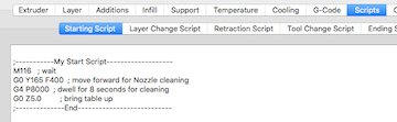

You can make your own start script - attached is mine but all you need is M116. M116 waits for all set points to reach target before printing. You can also do M190 and M109 with specific target temps but it gets confused - suggest just using M116. For a full list: http://reprap.org/wiki/G-code#

Ok, so M116 override that a G28 is sent to the printer before start the print?
What ever I put in to the script, the extruder and bed is G28 anyway before print =/
