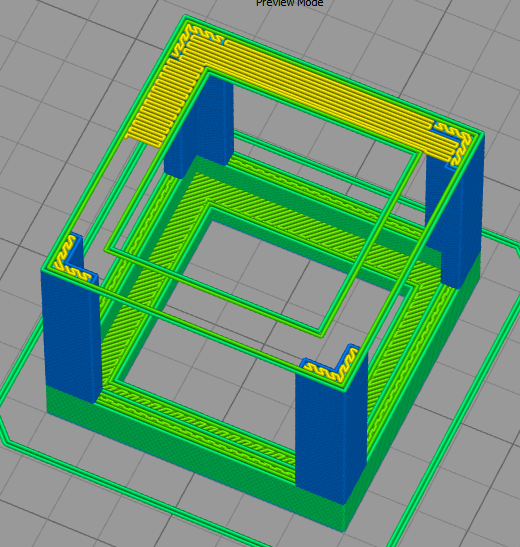

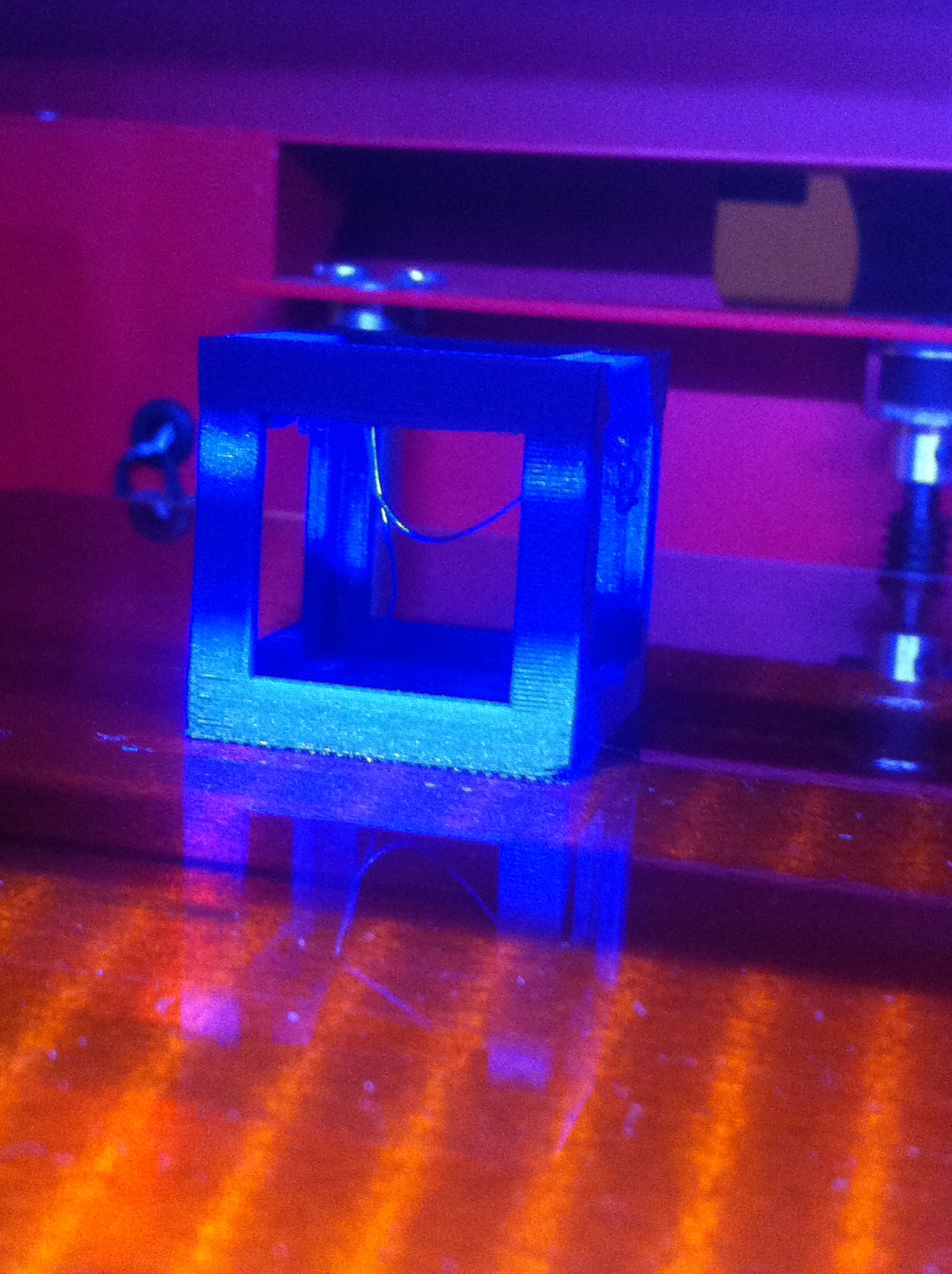

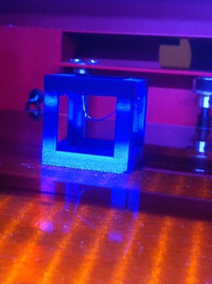

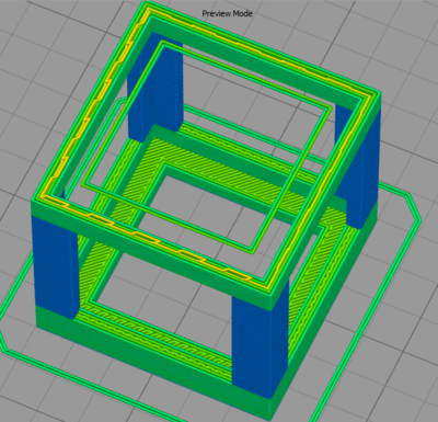

I purchased s3d yesterday to test it out, and a hollow cube without support was the first thing I tried as I wanted to see how forgiving the material could be so that I could consider this in future designs. Reviewing the layers before printing I found the same issue as you, layers in mid air. If the slicer had sliced horizontally between the existing sides of the cube when reaching the top, the 25mm or so open span would have barely sagged at all and printed ok. I let it print anyway, and even with the faulty slicing the front and back sections were almost perfect, but the sides much less so (the saggy bits in the photos and other detritis that isn't visible), which was inevitable for the way the slicing infill worked out.
Would be great if the slicer could handle this, and/or give the user the option to adjust slicing over a specifc set of layers plus the ability to add and remove tool paths because successful unsupported regions within reason are totally possible.
Re: Why does Simplify3D want to start a circle in mid-air?
Moggie - I've printed that cube many times before and never had any issues with how the software sliced it. Can you post your factory file (File > Save Factory File)?

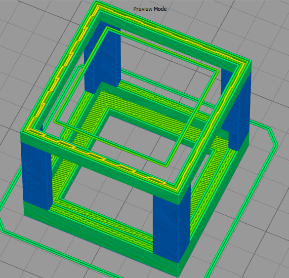

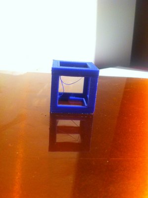

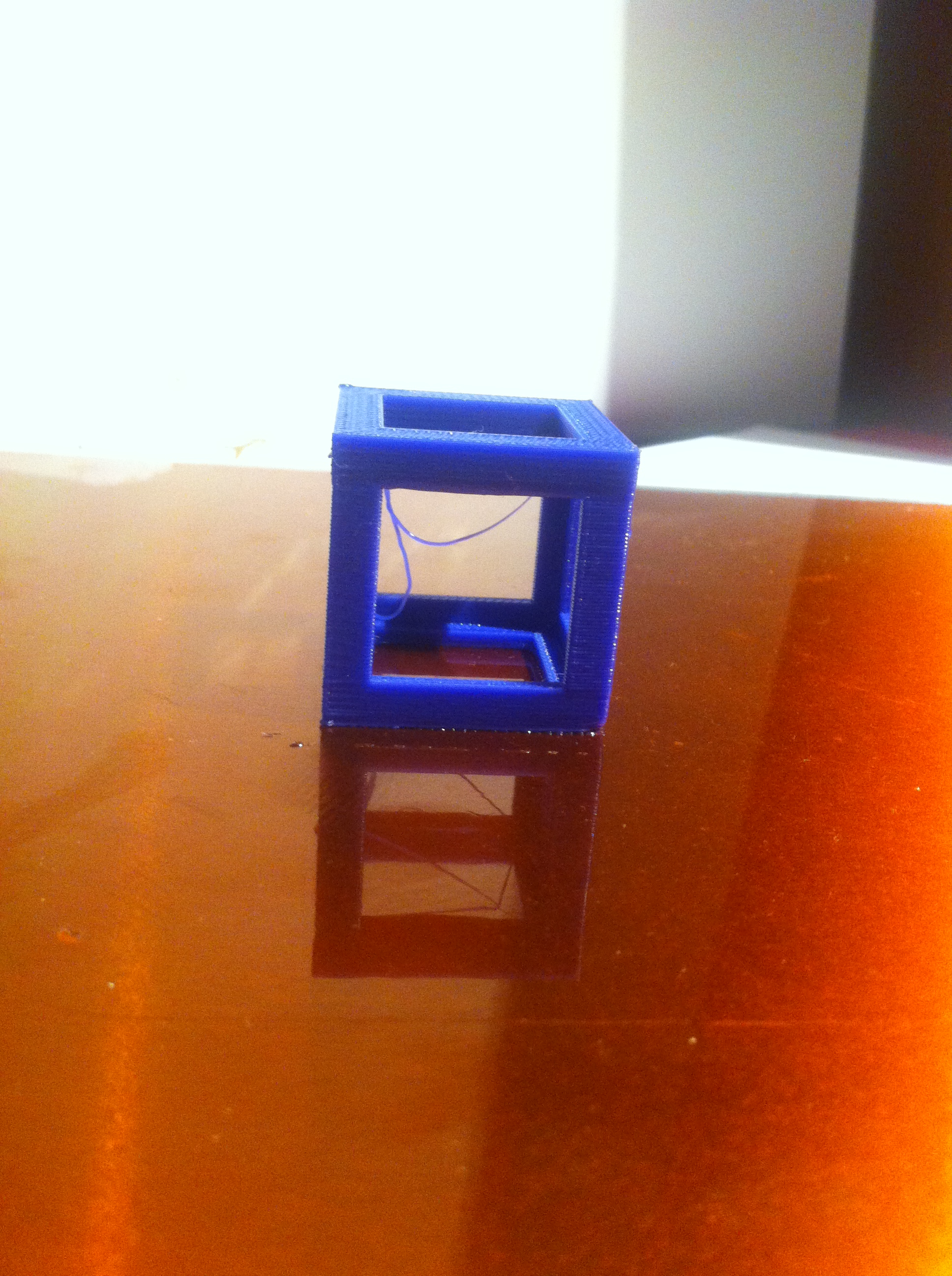

Sure. See attached zip with the freecad source, stl files and factory file for the second cube. I made two cubes, the second with a top without being inset internally. The images reveal the middle skirt created in mid-air, and on the second image, the infill was ok for the top front and back, but not suitable for the sides so that the outer layer didn't adhere. The top sides did form with subsequent layers, but had the first layer all curled up and stuck to them makng a cleanup difficult. I also tried different infill percentages and algorithms.
Honestly, I'm not sure how you would print that any better.. I think you need support material to get good results with that one. It isn't suitable for bridging, since there is nothing to bridge between on all of the inside perimeters.

The cube can definitely be printed without supports. It seems obvious to me. You bridge from one side to the other, then bridge from another side to the existing bridge.
Same goes for circles in mid-air. Bridge the edges of a square first, then print the circular section using the bridged square as "support" for the circular section. Circles are obviously going to be more difficult but it's still possible without printing completely mid-air.
