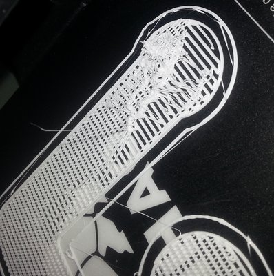

What is the reason for these broken prints?
sometimes, my prints look like the picture attached. How can I prevent this??
Re: What is the reason for these broken prints?
Looks like your bed it a bit too far away in that one corner. Try raising the bed some and maybe also slow down the print speed a bit to see if that helps
Thinking the same!
And a read of this wouldn't go amis....
https://www.simplify3d.com/support/prin ... eshooting/
I think most of us have been there, and learning how to resolve problems does have its rewards.
