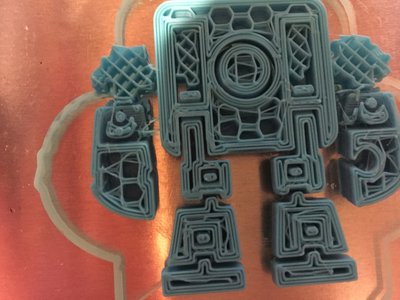

Can someone tell me what causes the problem shown in the picture? I have tried to print this object about 100 times now - all with approximately the same issue. The three perimeter walls become thinner and thinner as the object builds upwards, leading to either complete failure of the print, or an exceptionally weak object.
It does not appear to be a problem with the extrusion rate - although it looks like it. I can print a single wall cube of arbitrary size and the wall thickness will match the configured thickness. I can print a three perimeter, hollow cube (no top, bottom, or infill) and the three perimeters will print together like a single solid wall. I can do that with a larger cube so that the amount printed is closer to this model, and there is still no issue. If this is a problem with extrusions steps, I don't think any of those tests should have printed properly.
It does not appear to be a problem with retraction. I have tried many variations tweaking retract settings. My theory was that the biggest difference between this model and test cubes is the large amount of retract that takes place. After failing with many settings, I turned retract entirely off. The print was a wreck because of no retract - but it still showed the same thinning of the perimeter walls.
I have tried many different temperatures, all with the same results.
I am getting very frustrated with this, and have run out of ideas on what to try. Has anyone seen anything like this? Any ideas of what causes it and what the fix might be?
