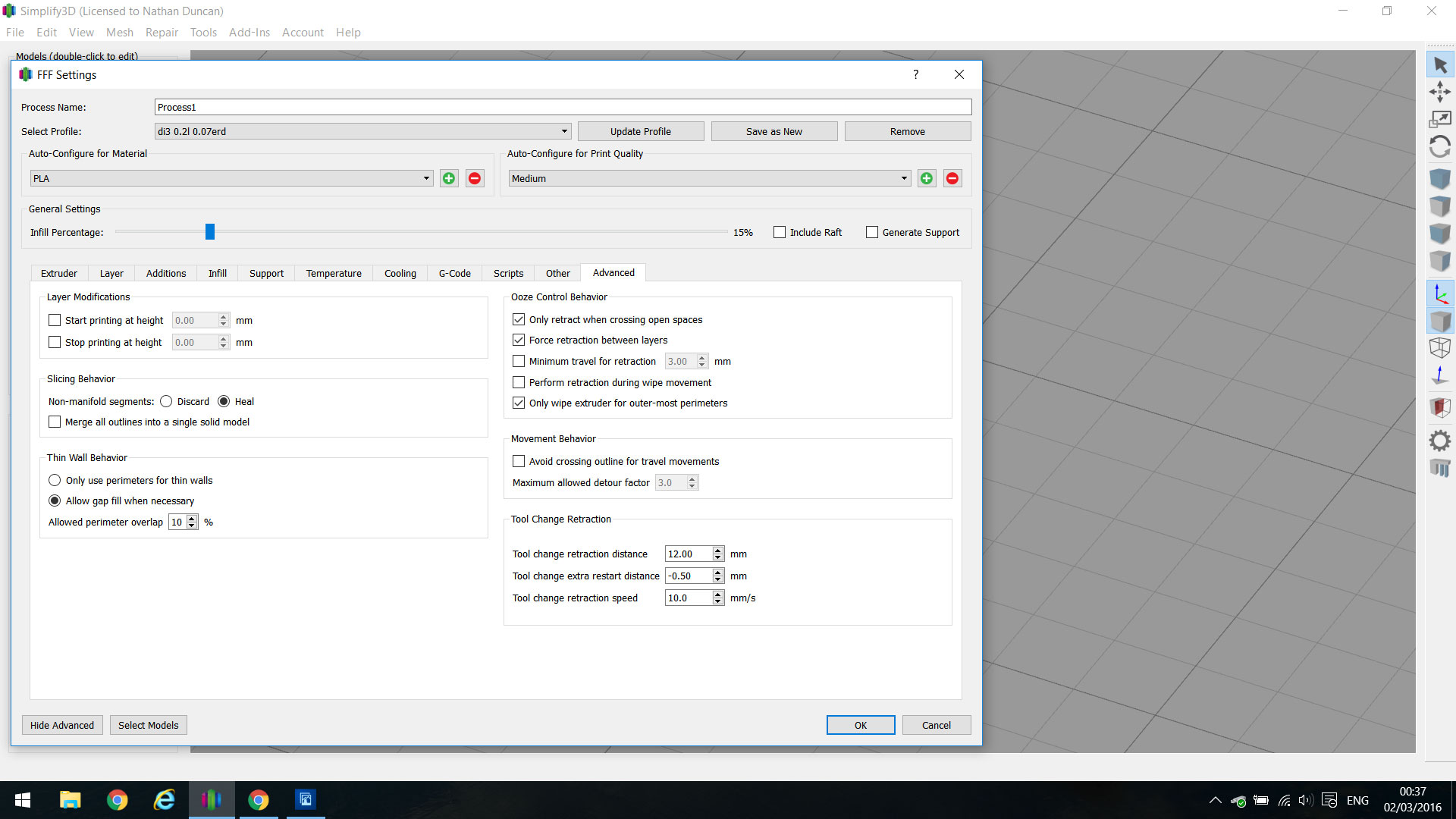

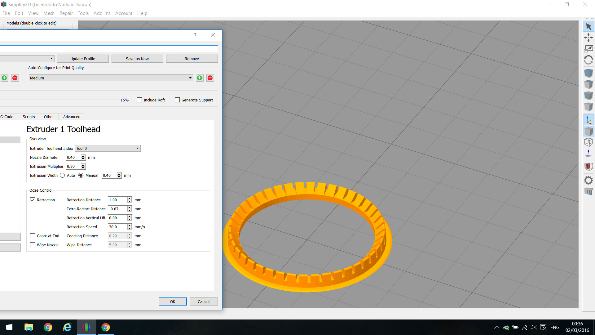

i had a problem with blobs at the start of a line, i added -0.2mm extra restart distance and the blobs have stopped, leaving a nice clean print.

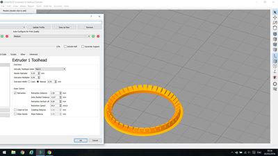

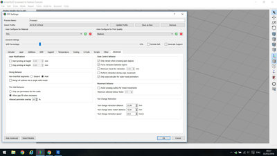

My problem now is that im printing a part with a small crown detail on the top . With the standard wanhao i3 setting it prints perfectly, apart from the blobs at the start of the line. with the -0.2m ERD i get a smooth print but it no longer prints the tiny fine crown detail as its constantly holding back the filament. i then tickeds the box for only retract if crossing more than 3mm and the crown detail printed again.
The ERD is also causing issues where its trying to infill small tight areas and not having enough primed PLA to extrude.
Is there a setting i can use to stop this happening or change is it possible to have a retraction/retraction speed setting so that i dont need to use ERD.
