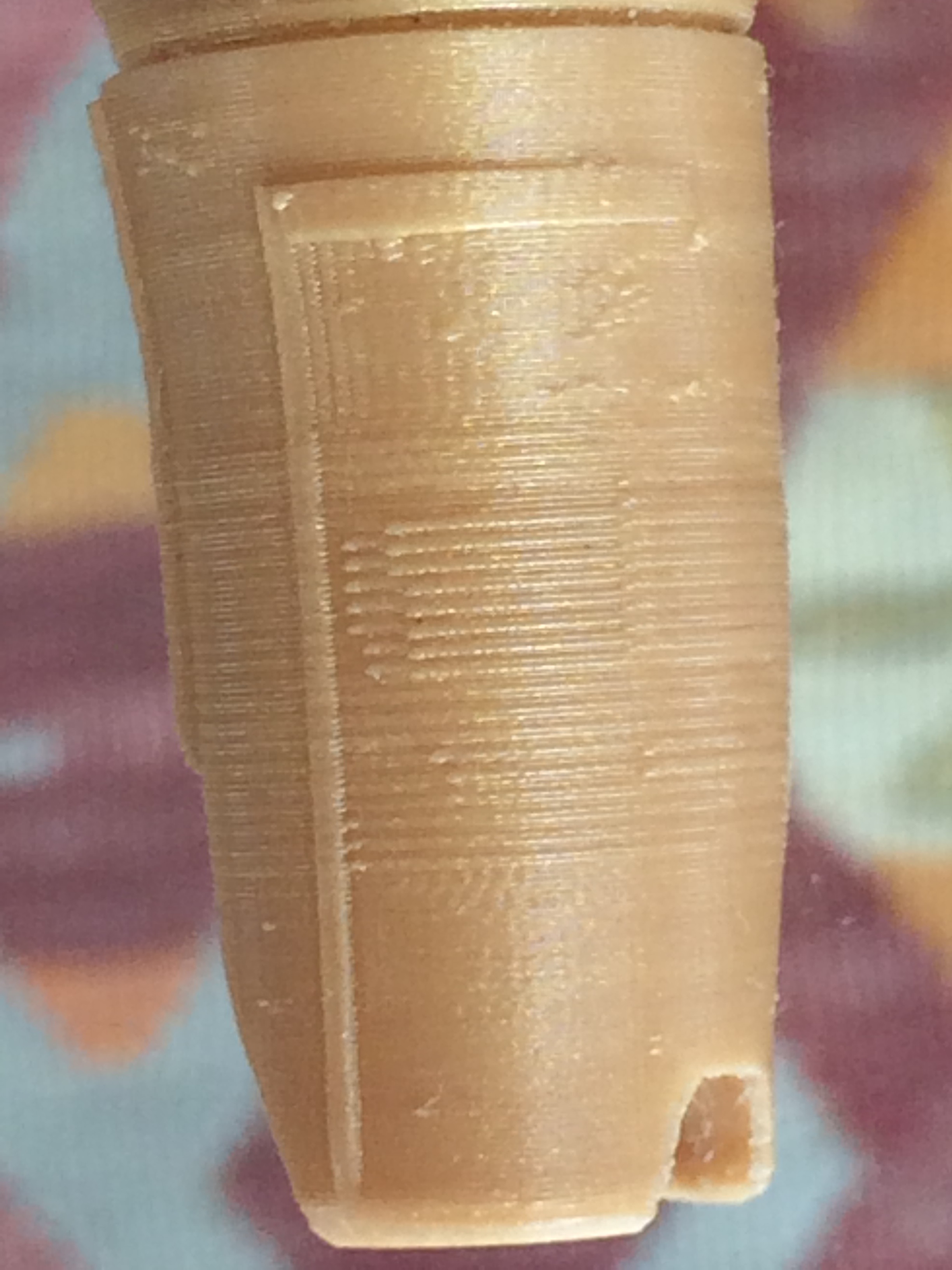

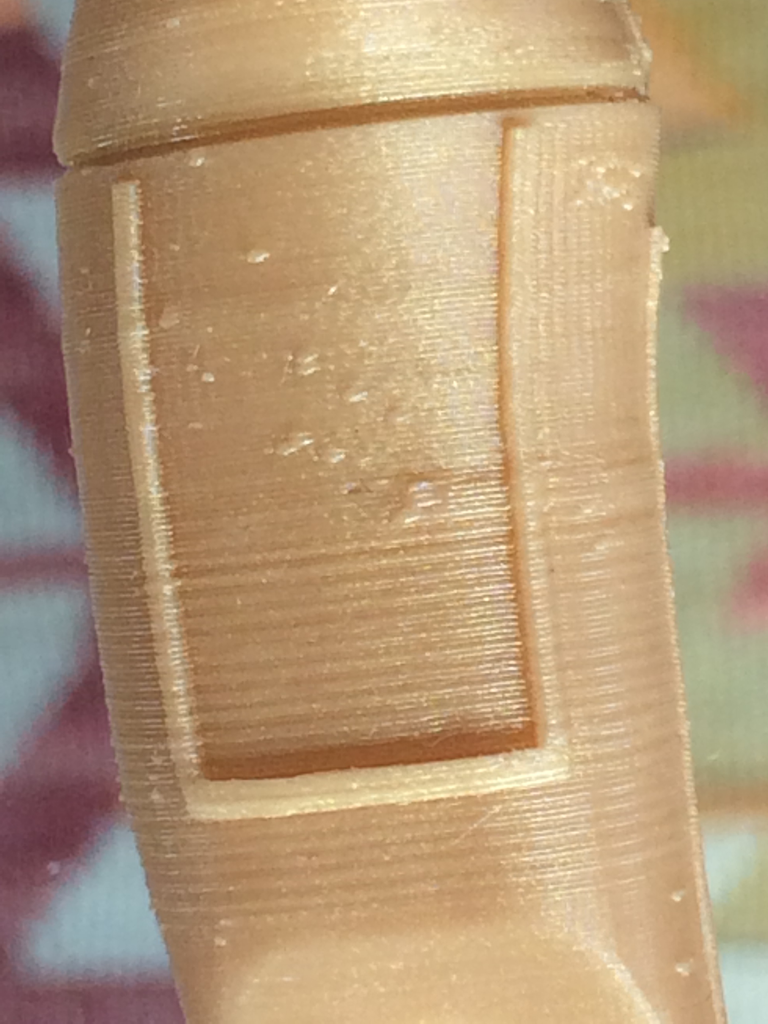

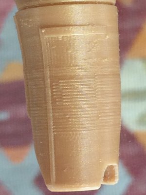

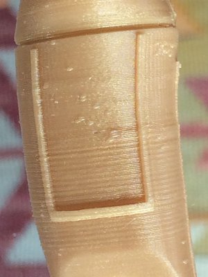

I have a issue printing PLA parts not solved by setting up Bondtech extruders and E3D V6 hotness + appropriate calibration on my Mankati Full-scale XT plus.
I have some blobs at the beginning of each perimeter, so accordingly with the guidelines, I have introduced some changes in the retraction with -0.02 extra restart distance, then -0.04 and -0.06. I have also tried the default setting in S3D 3.0 for my printer -0,13.
I have no effect on the blobs, but if I go over -0.06 on a part with many retractions I have holes at the beginning of the perimeter. And on a small part with more retractions, -0.02 is the max.
Nevertheless, I haven't managed to fix my issue working on that parameter.

parachutist
Joined: Sun Feb 07, 2016 8:46 pm
Re: Quality issue not solved
David,
I was having blobs that looked exactly like the ones in your pictures a few days ago. Then I read the link posted by CompoundCarl, and I tried something I found there: Enabling the FFF Settings -> Advanced -> Perform Retraction During Wipe Movement. (Wipe Nozzle must also be enabled for this to work).
That fixed my blobs issue
Chris

In the meantime, I have managed to get rid of the blobs using the Inside -> Outside perimeters printing instead of starting by the outer perimeter.
I know that it's a workaround, as the blob is now on the internal perimeter, but it works.
