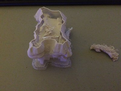

I've been trying to print a part in ABS, with HIPS support and an ooze shield. Bed adhesion and the HIPS part of printing is fine, however when it starts to print the actual model in ABS, it tends to "rock" a little as the ABS extruder prints, gets stuck to the extruder, and falls off of the print. I've attached a picture below.

The small piece to the right of the picture is the bottom of the print. It detached early on, but somehow was able to finish printing the model
