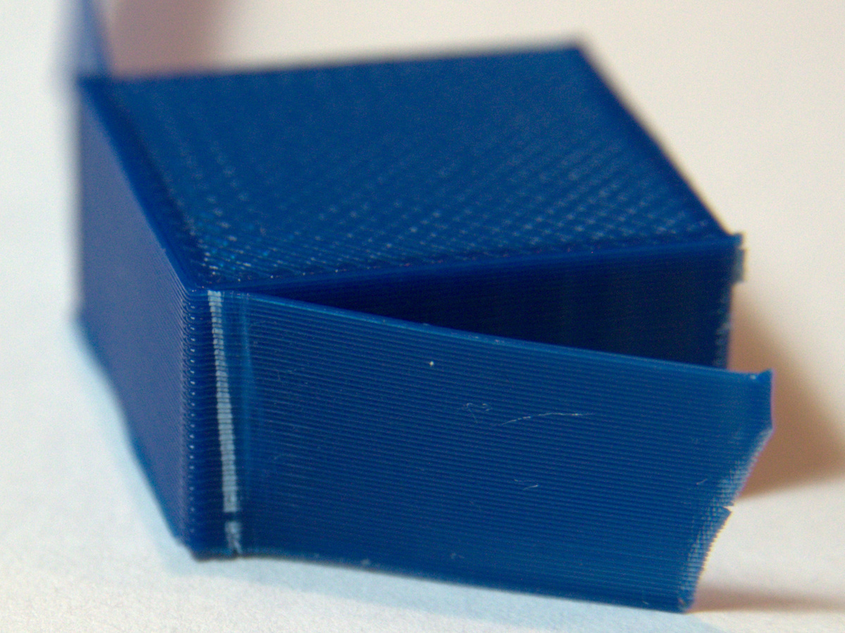

Using Raise3D N2 Dual with PolyMax PLA and latest (Aug 1, 2016) S3D Raise3D profiles. Printing using "Medium."

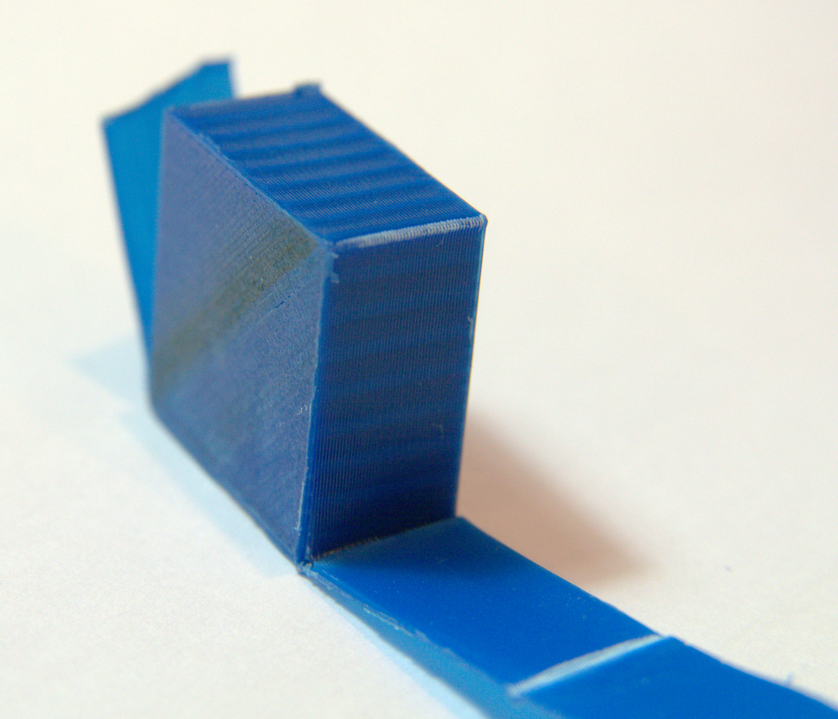

The calibration box printed beautifully with one exception: The first outer shell is loose from the rest of the print. The odd thing is that all the other shells and layers are nicely fused. I haven't seen this behavior before and this is my first print using S3D. Any ideas?
Temperature: 215C
First layer temp: 210
Bed temp: 60C
Infill: 100% grid
Layer height: 0.20
Nozzle: 0.40
Perimeter shells: 2
Default speed: 60 mm/s

Sorry, no. After I changed the extrusion multiplier to 0.97 I got a perfect looking box - flat on top, no ringing, smooth. Really nice, but then my thumbnail slide right in between the shells again. The two outer shells are loose enough to strum like a guitar. If I increase the flow, the box will be convex on top.
