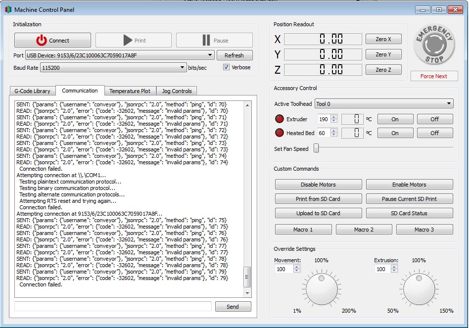

Difficulty connecting to Makerbot Z18
I have stopped the makerware services in the background and still no luck connecting to my Z18 via machine control panel or printing over usb. besides, I was expecting to see load filament,... instead of Macro1 Macro 2, ... buttons! is there anything I should do to fix this? I have no problem connecting to my replicator 2x , this only happens on Z18

It seems in the pic you put up that the port showing is similar to what I saw on line researching. I did see the load - unload buttons as you were expecting. Two things to try:
