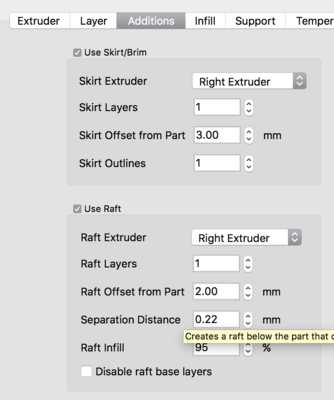

2) For the raft, you will find a setting for the raft that lets you pick how much of an gap you will have between the raft and first layer of the model, see "separation Distance"
Also it's best to let the print cool down first.
